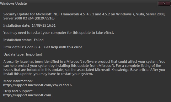

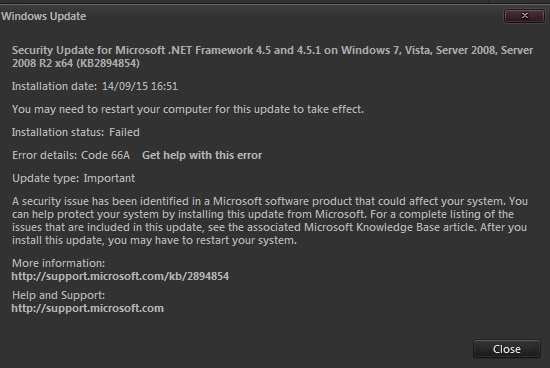

Hi there,
The subject, windows update fails to updates and KB2894854 and keep asking to them. What should I do?

    Check the date and time on your computer. You seem to be year ahead of the rest of us!
    2014-09-15T10:05:17+00:00
    Here you are,
