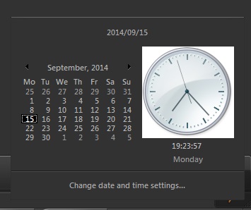

    2014-09-15T12:23:26+00:00
    That is strange.
    The two images of the failed updates you posted earlier both have the line:
    Installation date: 14/09/15 16:51.
    I cannot recall ever seeing the date format as YY/MM/DD. I have seen DD/MM/YY (UK) and MM/DD/YY (US and elsewhere). I have checked and you can use YY/MM/DD.
    We learn something new every day.

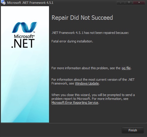

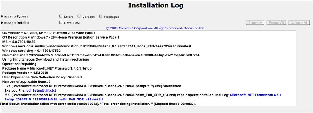

    2014-09-15T11:30:47+00:00
    A.    Click on Start and click on Control panel.
    B.    Go to Program and Features.
    C.    Scroll down to Microsoft.Net Framework 4 Client Profile, right click it.
    D.   It will give you a choice of Uninstall/Change, click it.
    E.    Then, it will give a choice to Repair it, pick Repair  it. It will take about 4-10 minutes to repair (with my PC) your experience may vary.
    F.     When completed, go to your update center, and update it again.
    Source: Moek2 http://answers.microsoft.com/en-us/windows/forum/windows_xp-windows_update/error-code-66a-net-framework-4/1307e399-8997-41c4-9d3b-24f872425148
    Nah, that did not work.
    2014-09-15T11:27:07+00:00
    Check the date and time on your computer. You seem to be year ahead of the rest of us!
    Nope,
