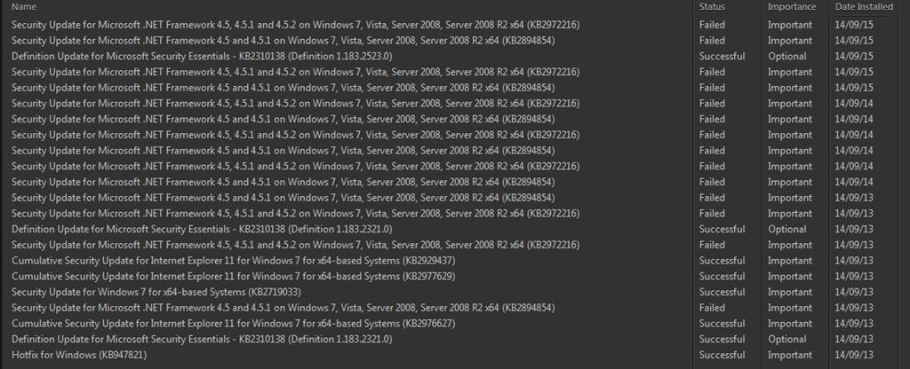

    Select Start, All Programs, Windows Update, View Update History, double click the failed update and post the Failure Code and Update reference number?

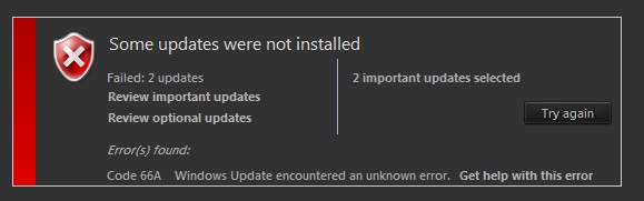

    More over, now, whether was attempt to update or not, the system "restart" reminder persist every time:
    2014-09-15T08:53:16+00:00
    What are the failure codes now?
    I do not know what you have done :), but the code is changed to 66a now and I still cannot update :(
