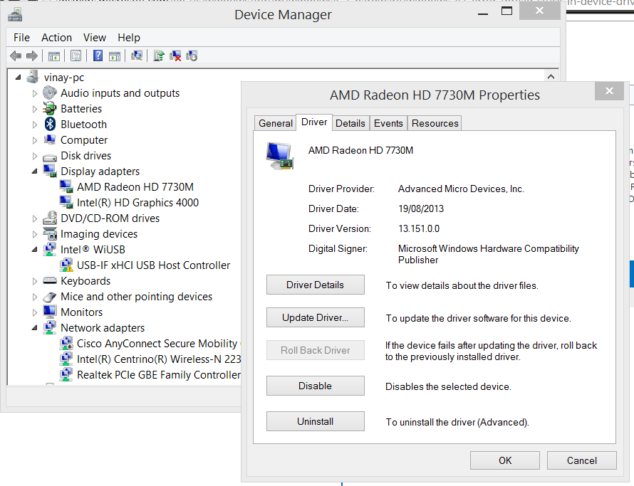

    Did uninstalling the AMD radeon drivers through device manager (like shown below) cause any problems?

    I had a similar issue.  It turned out to be the AMD 7730M drivers.
    After upgrading to Windows 8.1, my Dell Inspiron laptop would no longer sleep.  Any attempt to make it sleep would result in a full restart.  I tried to update the Catalyst drivers, but any attempt to remove/upgrade the drivers using the Catalyst software resulted in a blue screen crash, with the same thread_stuck_in_device_driver error.  In the end, I uninstalled the AMD Radeon HD 7730M device through the Device Manager, and then installed the lastest AMD drivers from the Dell website.  This fixed the issue and my laptop now sleeps again.  No more blue screens.
    Hi Dash,
    The same thing happened to me when I upgraded to Windows 8.1. uninstalling and installing the AMD Radeon HD 7730M device fixed the thread_stuck_in_device_driver error. However, every time I put it to sleep, it still results in a full restart.
    Has anyone been able to resolve this issue?

    Hi JordanQuiroz,
    Did you actually reinstall the drivers? I downloaded and installed from the Dell support site (enter your service tag and let it show the available drivers) - rather than downloading from the Microsoft site. I had to reinstall the wifi and bluetooth drivers because my wifi was not working at all, but it was when I subsequently installed the AMD Radeon driver that it fixed my THREAD_STUCK_IN_DEVICE_DRIVER problem.
