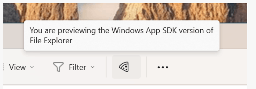

    Pizza slice in file explorer anybody? 🤣🤣🤣

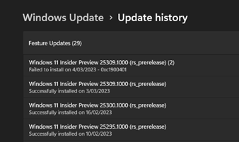

    First try failed:
    Install error - 0xc1900101

    Thanks Sibro. It didn't show the error code when I rebooted back to 25300,, so I used CK's suggestion to use Update History. All it shows is the code 0xc19000101. I'll try some of the suggestions in that link tomorrow when I have time.
