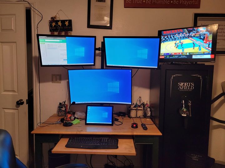

    Very helpful. Can you confirm you are extending to all 4 displays and not mirroring on any of them using the wireless HDMI adapter? I can get 3 external monitors but not the Surface (pro 6) which I didn't think was an issue until I realized none of my monitors have sound. I would prefer my setup to look exactly like yours with the surface in the middle as long as each of the 4 screens works independently and doesn't just replicate another display.
    Thanks!
    All 4 are independent. I’ll try to post some pics of the cabling when i get a moment.
    Michael, did you get a chance to post a picture of the cabling?
    I have connected 2 monitors to the Surface dock and a third into the Surface itself, but it doesnt allow me to use the surface as a screen.
    How were you able to extend display onto all 4 screens?
