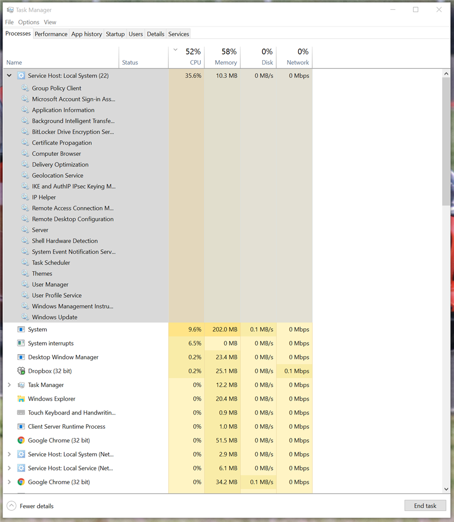

    2016-06-18T08:00:02+00:00
    And the list of running processes sorted by CPU looks like this. Note that there are no foreground applications running and all the background tasks are running at 0% or very close to it so pretty much the only thing running on the machine it the Windows 10 operating system.
