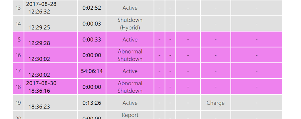

    Please start a new thread about your battery issue (and as I understand it, you
    have a SP 3 and not a 4 and you need to post in the Surface Pro 3 topic (as there have been known issues with the batteries in the SP3).
    >> Something wrong with the battery.
    2017-08-30T21:46:22+00:00
    Good the battery of my surface was zaro, drained, I left one day without turning on and when I turned on the keyboard it turned on. Something wrong with the battery.
    What is?
