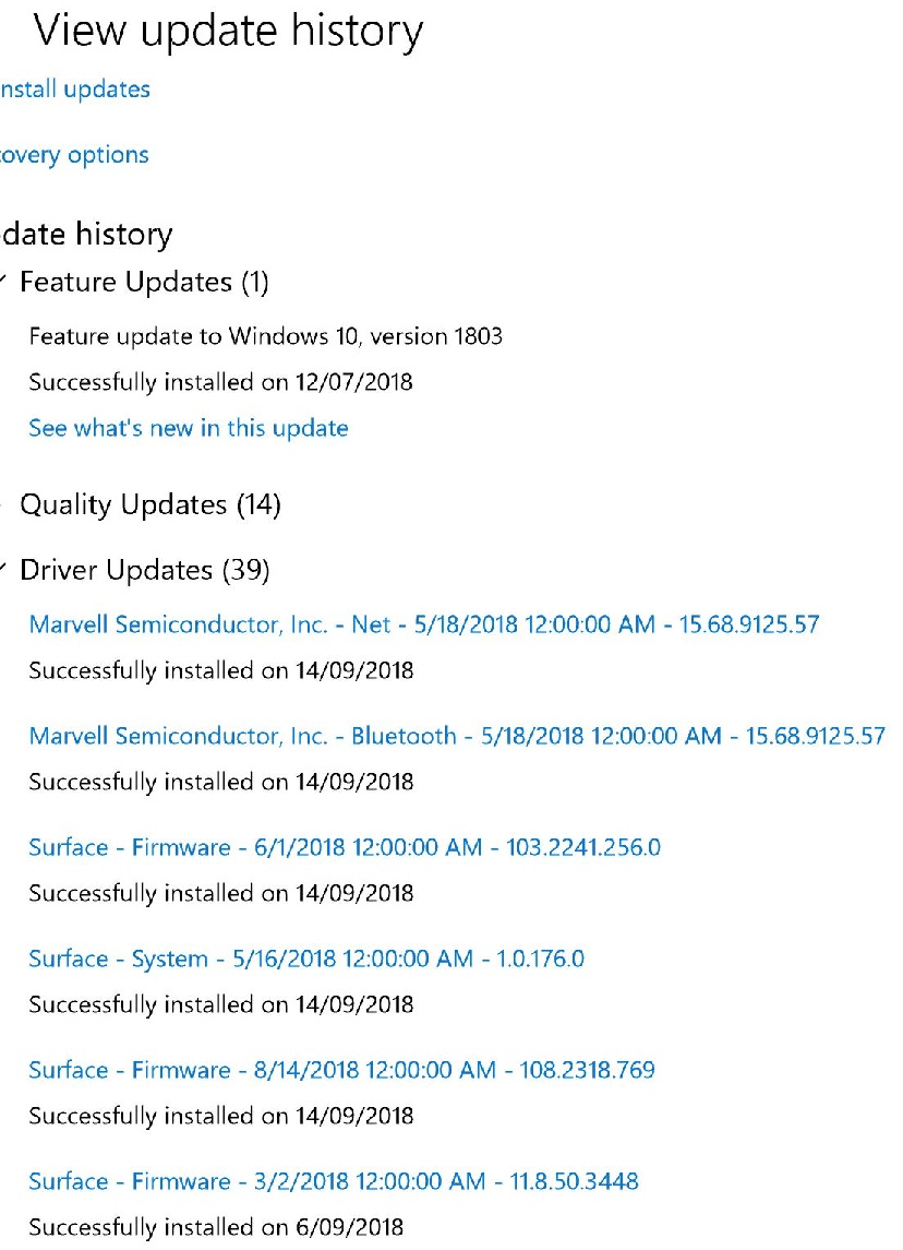

    2018-10-17T12:10:21+00:00
    The keyboard cover of my SP4 stopped working on 14 September 2018 IMMEDIATELY AFTER a Windows update.
    That day, I initially turned the device on... keyboard working.... I manually clicked 'Install Updates' and watched it install firmware and a few patches.... the keyboard no longer works.
    This is definitely NOT a hardware fault - unless Microsoft are saying that our devices are running older hardware which is no longer supported?
    Or, playing devil's advocate here, is it a ruse to generate revenue by making devices appear to be defective?
    I will add, that there is no device driver listed in Device Manager for the cover keyboard.
    Location: Australia.
    Remedial Actions: As per many suggestions, hard reset, running diagnostic tools, reloading drivers from MS Website etc.
    Spoke to MS Support for around an hour, went through everything except USB re-install. Nothing worked.
