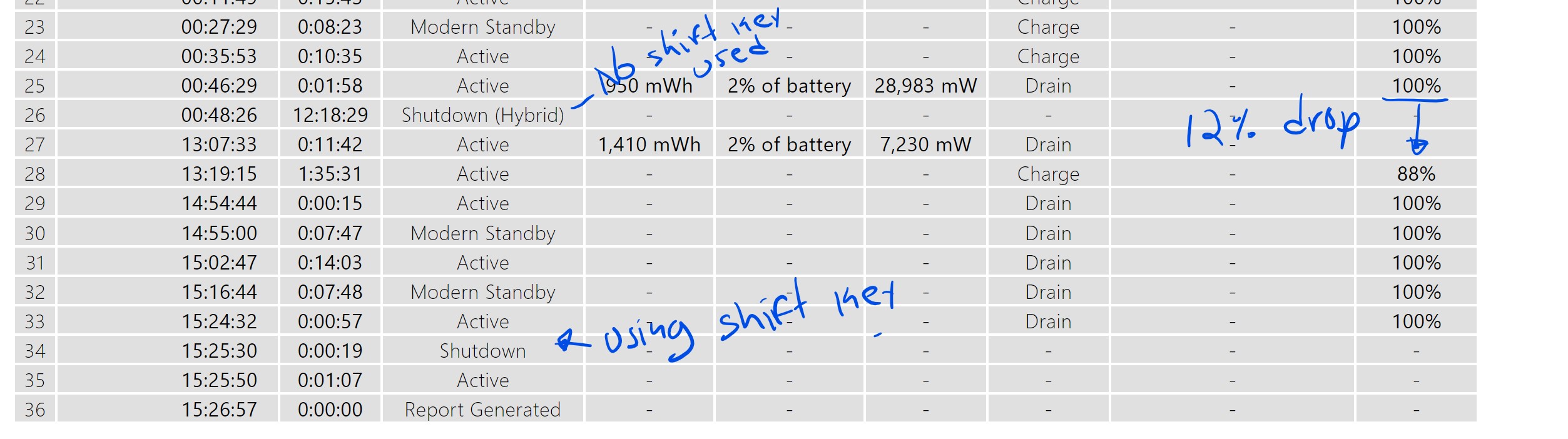

    The battery drain on Surface Book 2 is due to the new hybrid shutdown mechanism used in these devices, which keeps the core of the operating system in RAM while the computer is turned off to provide the fast boot function. This feature, along with a new connected standby state, are new features built into surface devices.
    To prevent the system from shutting down using hybrid shutdown, you can press the Shift key while selecting the shutdown option from the start menu.
