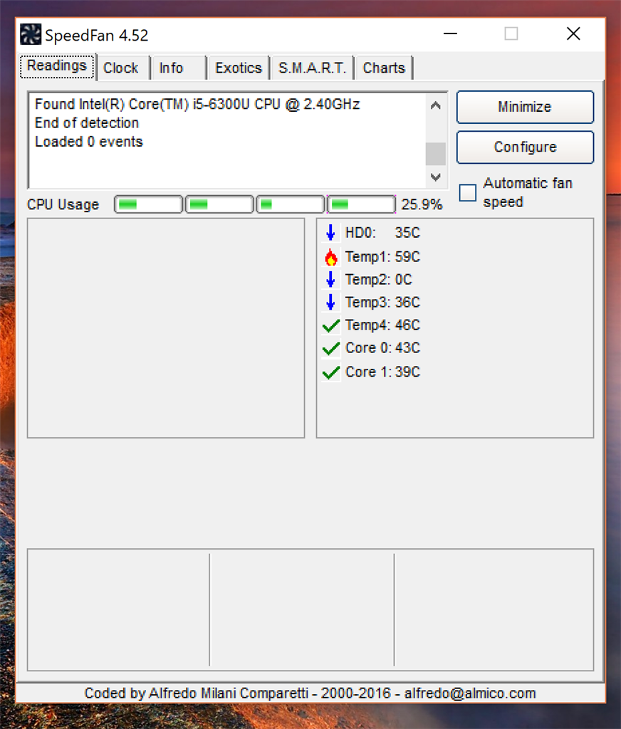

    I used this software called SpeedFan just to get some temperature readings. I noticed most flicker when the Temp1: was at 60C+ Screen would flicker constantly above that, even when something was moving on screen, or while I was gaming. Between 40C and 60C screen would flicker while something was not moving on screen. Below 40C I had no issues.

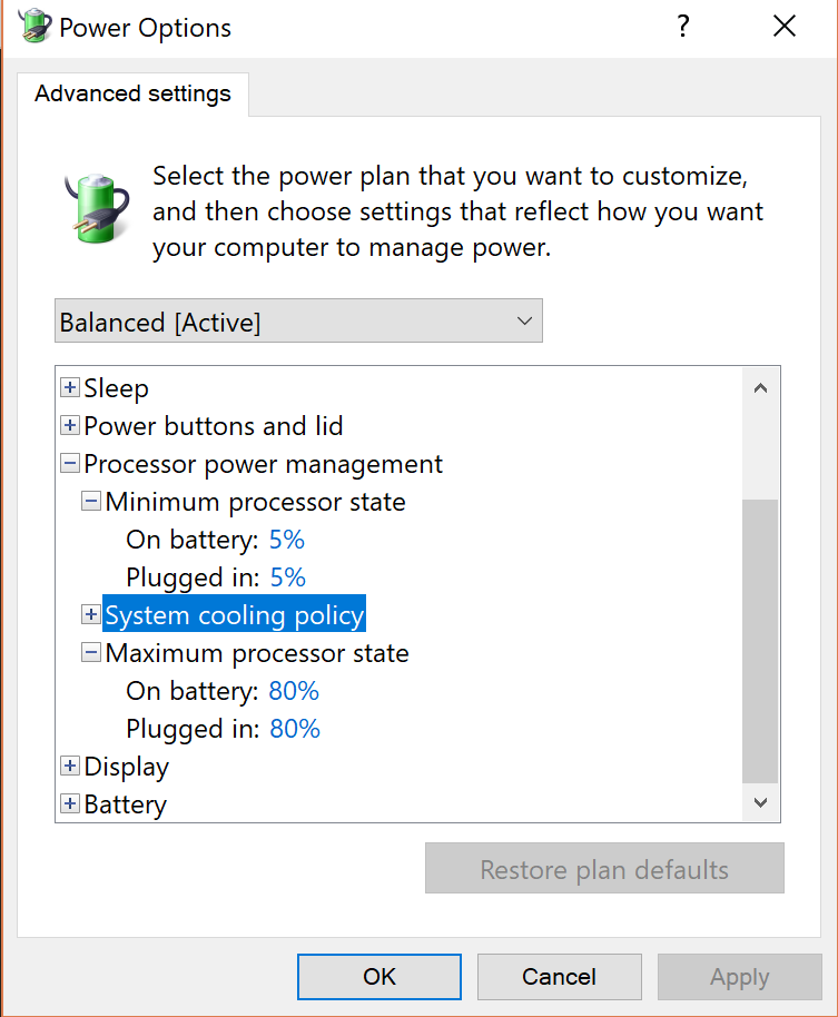

    Step 2: Change the Power settings.
    The more power your CPU uses, the more heat is generated. These settings are hidden on the Surface but you can add them manually for more control. Changing power setting to maximum Battery life might be enough, but if you want more control you can change the maximum and minimum processor state by adding them to the power options
    This can help a lot if you have a very bad case of flicker, but it will also reduce the performance of the device a bit. Try setting it lower to reduce the heat produced by the CPU.

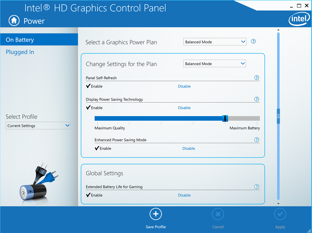

    After installing you now have access to the intel control panel. Which looks like this.
    Here you can do some further settings to reduce the heat produced. The settings above seemed to work well for me. No flicker even during heavy gaming, but I did notice a bit of loss in FPS in some games. But I'd rather have that than constant screen flicker.
    To add these settings you can go to this link.
