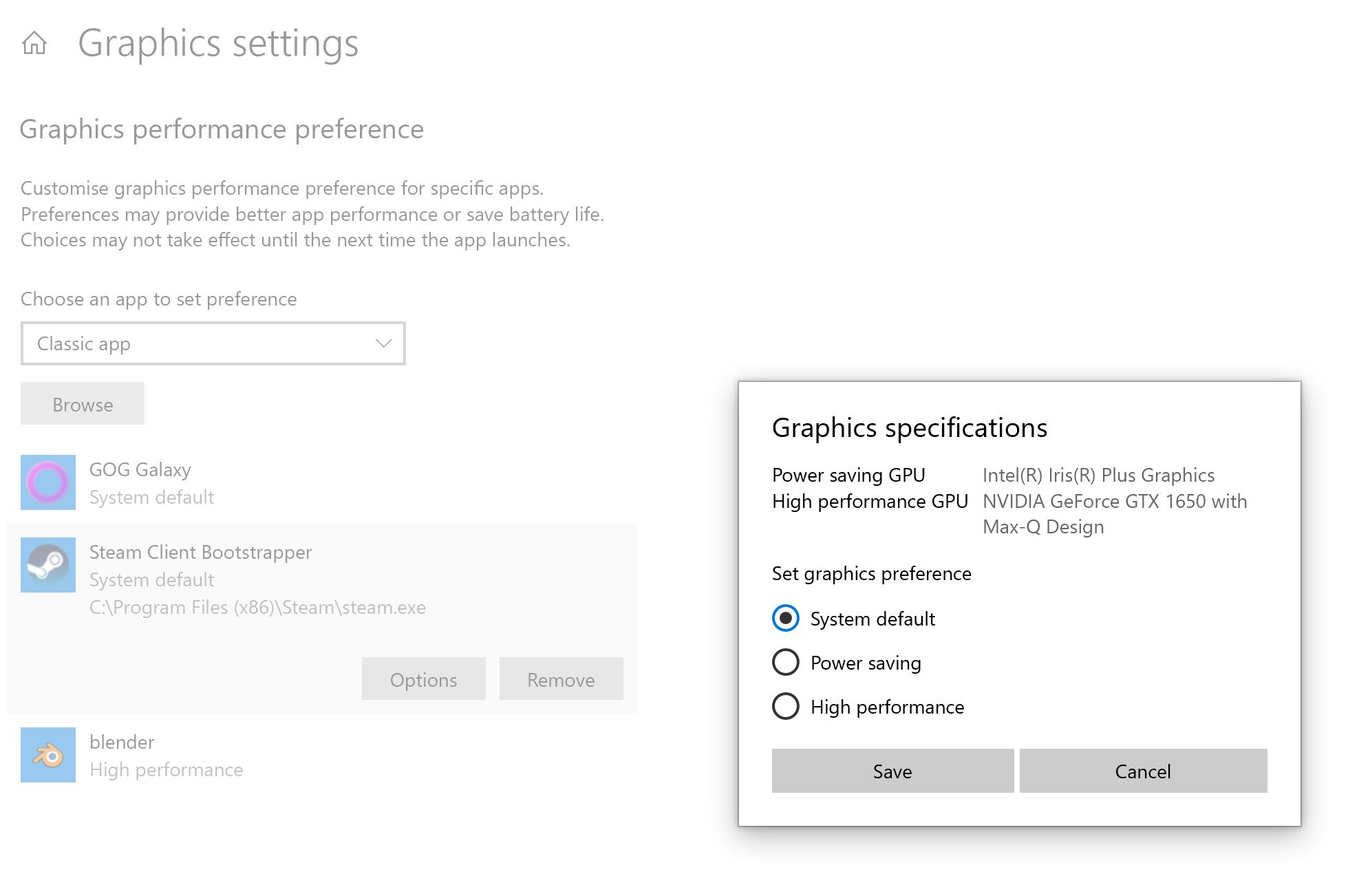

    I thought that the problem may be that the graphics options were set too high for the GPU but even when I reduced these to the bare minimum the problem persisted. (As a side-note, I believe I amended the graphics settings to ensure that Steam, etc. was utilising the GPU - please see screenshot). Alas, this didn't work. I thought perhaps because this is a 2020 game that it might just be too demanding for the graphics card so I downloaded Theme Hospital via GOG.
