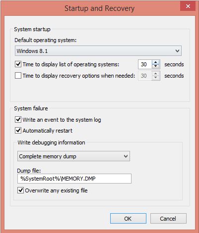

    We'd like to capture Kernel Dump files and Event Viewer Logs from when the Surface randomly restarts.
    To enable Kernel-Mode Dump Files, please do the following:
    1. Go to %SystemRoot% which is usually C:\Windows and delete any Memory.dmp files that currently exist.
    2. Go to Control Panel > System and Security > System.
    3. Click on Advanced System Settings
    4. Go to the Advanced Tab if it does not automatically go there
    5. Click on Settingsunder Startup and Recovery,
    6. The settings in the window should be:
    When the Surface randomly restarts, please collect the Dump file, and Event Viewer data (below) add it to OneDrive, then post the link for us please.
