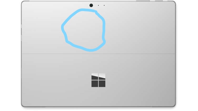

    I use C:\Windows\System32\shutdown.exe /s /t 3 /c "Full Shutdown" and I didn't attach the typecover for the tests above. It doesn't make sounds while shutdown (it's an i5 model, just in case, it has a fan).
    I "store" my Surface Pro 4 with the power adapter attached (to make sure that it doesn't ruin the battery). In that case, the area below the camera on the back is a warm (while OFF). It should not be related to charging, because the battery was at 100%.
    I normally disconnect the power adapter from the device, not from the outlet. If I leave it disconnected from power, it doesn't warm up in the marked area (while OFF).
