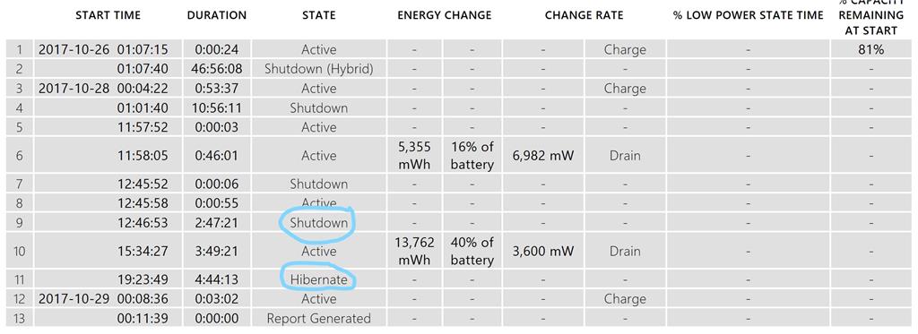

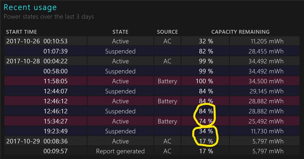

    2017-10-28T16:22:21+00:00
    In my case the command doesn't help :(
    Here my reports ... Interestingly, the power consumption when OFF is about the same as the power consumption in Hibernate state ...
