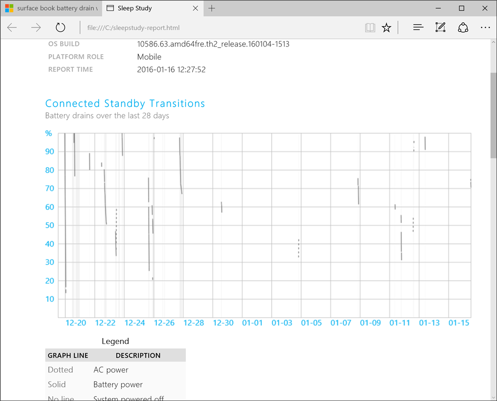

    My surface book is experiencing the same problem with battery drain after shutdown.  Full charge ==> shutdown ==> 3 days later down to 75%.   I want so much to like the SB but this is ridiculous!
    Attached is the powercfg showing Full Charge on Jan 13, 2016 with no usage until turn on on Jan 16, 2016.  All updates applied.  No extra software installed ..not even office.  Connected Standby disabled.
