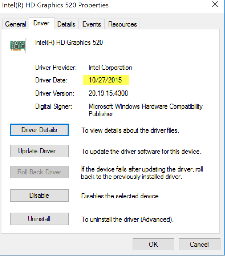

    2015-11-03T18:15:43+00:00
    Thanks for this suggestion.  Unfortunately, I just checked in Device Manager and the driver for the Intel HD Graphics 520 is listed with a date of 10/27/15 and version is 20.19.15.4308.
    2015-11-03T18:00:54+00:00
    I applied the 11/2 update to my Surface Pro 4, but am still having intermittent "Display driver stopped responding and has recovered" messages after the update.
    might want to make sure your intel graphics display adapter has a driver date of 10/27. If not then you do not have the updates completed. Uninstall and reinstall.
