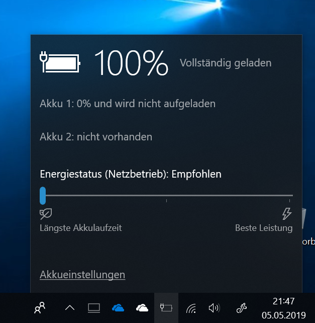

    2019-05-06T10:49:50+00:00
    I'm not sure to have the same battery problem. I wasn't able to detach the tablet. Then i used the paperclip method to release the tablet. Afterwards i switched it on (with no charger connected) and it was working properly. I was surprised to see this battery information: 100% charged and Battery 1: 0%, ... ? Do you have any ideas?
    Thank you!
