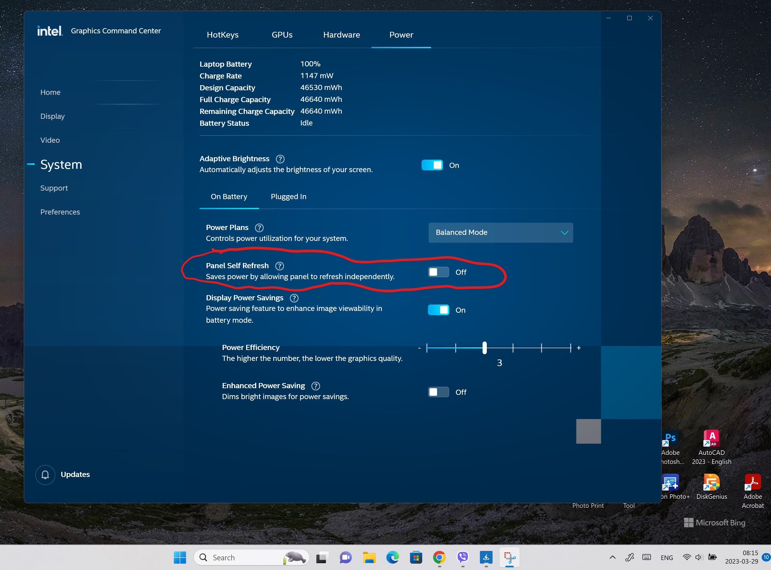

    2023-03-29T05:20:46+00:00
    YES !!!! It is ! Same on w11. I tested yesterday, no tear or blink.
