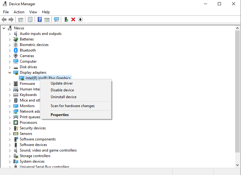

    8/23/2021 Fix update:
    Bought a new SL3 to connect with my Surface Dock one, and had the same use with the resolution being stuck. I am not technologically savvy but this fix worked for me.
    This is an update to the previously described fix which included rolling back the intel driver. The previous links for the intel drivers are no longer working. I found an old MSI file from 8/2019 that worked for me (the previous one was from 11/2019).
    Here is a link to that MSI file: https://drive.google.com/file/d/1vnrHj4Hn8vmxNhBR2v6C0DgP2La-IvaE/view?usp=sharing
    Instructions:
    Note: Prior to this I updated my surface dock firmware (https://support.microsoft.com/en-us/surface/update-your-surface-dock-58d8723e-eae8-5e8d-c295-f870f7703633) and cleared the cache (https://support.microsoft.com/en-us/surface/troubleshoot-connecting-surface-to-a-second-screen-bc8f5121-a4cb-cf0b-5770-2df7a66a3b28#bkmk_cleardisplaycache). If the second link download doesn't work, open it in a new window in your internet browser. I am not sure if these steps were part of the fix but wanted to include them.
    1. Download the above MSI file.
    2. Uninstall your current intel Iris graphics card in device manager (right-click the windows button and go to device manager - see screenshot).
    3. Install the downloaded MSI file (I did not need to extract this, it just ran automatically).
    4. Restart your computer.
    5. Unplug your surface dock connections (power and displayport) and replug them in.
    I hope this helps someone. Let me know if you have questions.
