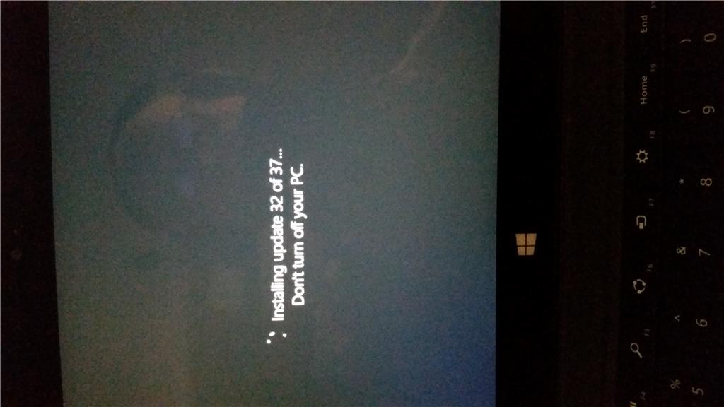

    and now just after installing just a few updates not all i can't access anything in the app store so it has to be in one of those updates that is causing the problem. ok i think i have figured out the problem there is a firmware update that is causing the problem i have installed all updates except the firmware update and i can access apps and install from the store and find updates so the firmware update i beleave is the problem.
    2016-12-19T20:48:18+00:00
    and here is another picture of it installing updates this is why i think one of the updates is the problem.
