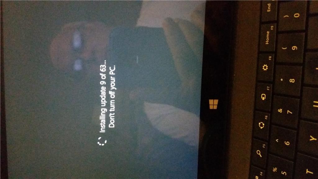

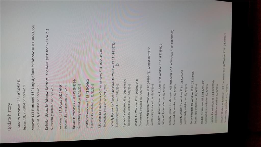

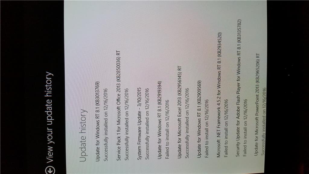

    OPk here is the realy weird thing i reset my surface Rt back to factory settings like i just bought it from the store and lowe and behold it installed all kinds of updates and i even managed to download a few apps from the microsoft app store with no problem then after it installed a few more updates it has been searching for updates for about an hour to an hour and a half and now i can't download anything from the app store i think there is a couple of updates that is causing this problem but witch ones i do not know it was fine until i installed updates 3 different times and after the last ones now all of a sudden no updates can be found and i can't do anything on the app store so it has to be 1 or more updates causing this problem but since this surface is out of warranty microsoft will more than likely do nothing about it so w are probably stuck with this tablet like it is. and here is pictures of it installing updates and the list of updates that it has installed so far.
