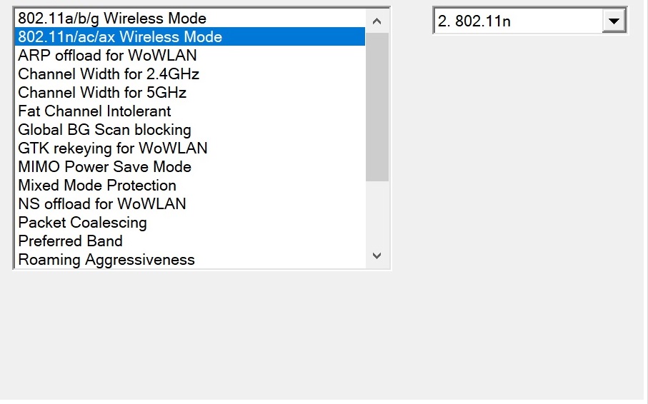

    Hi AdamC Thanks for the advice. I may be a total idiot, but can you please advise where to find the menu screenshotted above? I'm not very techy and am currently working on final college assessment and this issue is driving me mad. Mine is a Surface Pro3
    Hi, if you have Surface pro 3 then it may not apply to you, you may have different WiFi adapter and different options. I am referring to Surface Pro 7. The menu I refer to you may find by opening Device Manager (start menu, type: device manager and launch it). In the tree, navigate to 'Network adapters', choose your WiFi card, right click it, choose 'Properties' and here you are.
    Hope this helps, but I doubt if Surface Pro 3 issue is the same.

    For me the issue is resolved permanently by applying card config change as I described on 29th of March earlier in this thread. It is not perfect, but it works.
    2020-03-26T10:53:59+00:00
    Try disabling AX and AC mode. I switched to N mode and no issues so far (few power on / sleep wake ups). Screenshot attached. Will keep posting the status.
