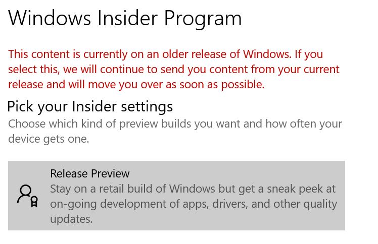

    I never did "skip ahead" but when I try to switch to the "release preview" as you suggest I get the message below. Once I leave the settings menu and return it seems that I'm back on "slow (recommended)".
    Maybe I'll just opt out of this whole Insider thing and hope that the fix is released publicly soon.
  2. Barb Bowman 80,805 Reputation points MVP Volunteer Moderator
    2019-09-21T10:48:10+00:00
    If you joined SKIP AHEAD and not RELEASE PREVIEW there could be all kinds of
    other issues that muddy things. 20H1 (Skip Ahead and Fast Ring) are early betas
    for next springs release. If you are within 10 days, roll back to your previous
    version of Windows. Leave Insiders. Reboot twice after rolling back. Then join
    release preview. Release Preview is drivers and firmware and they are rolling
    out 1909 (19H2) and not next years betas.
