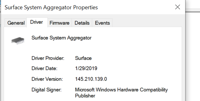

Please see https://support.microsoft.com/en-us/help/4469839/surface-laptop-2-update-history
This should be available on Windows Update:
October 10 release
The following updates are available for all Surface Laptop 2 devices running Windows 10 April 2018 Update, version 1803 or greater:
Windows Update History Name Device Manager Name
Surface – Firmware – 145.501.139.0 Surface System Aggregator– Firmware<br><br><ul><br><li><span>145.501.139.0 helps improve battery life.</span></li></ul>
