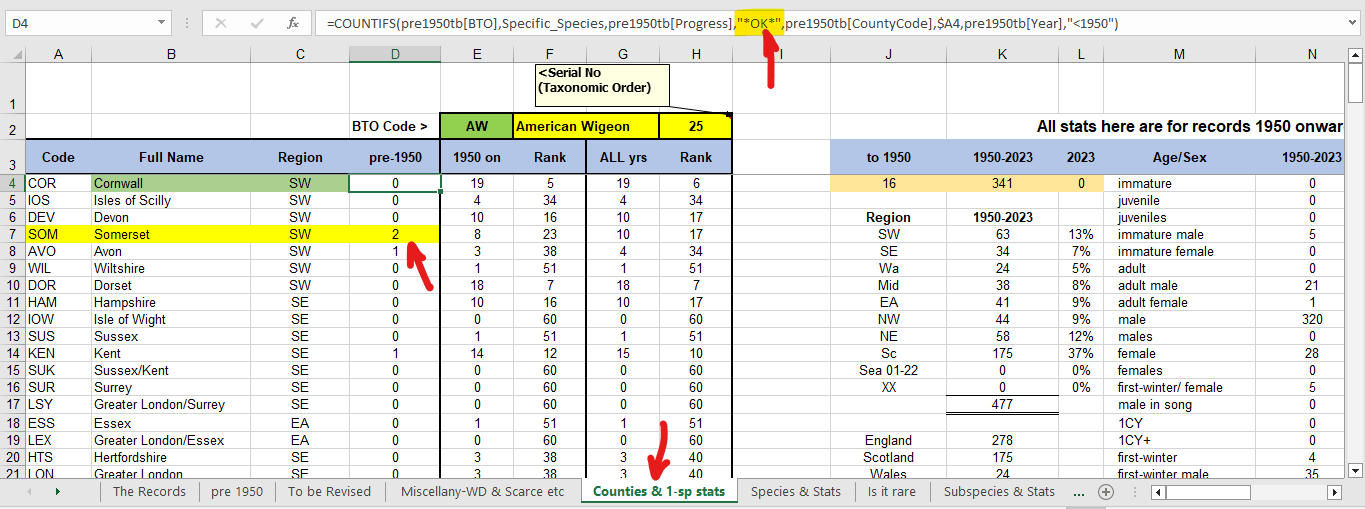

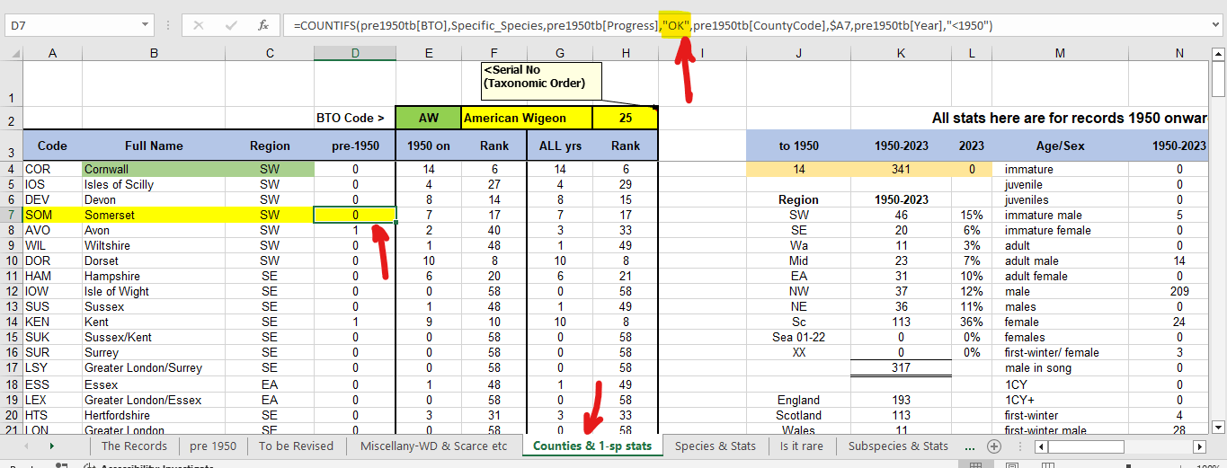

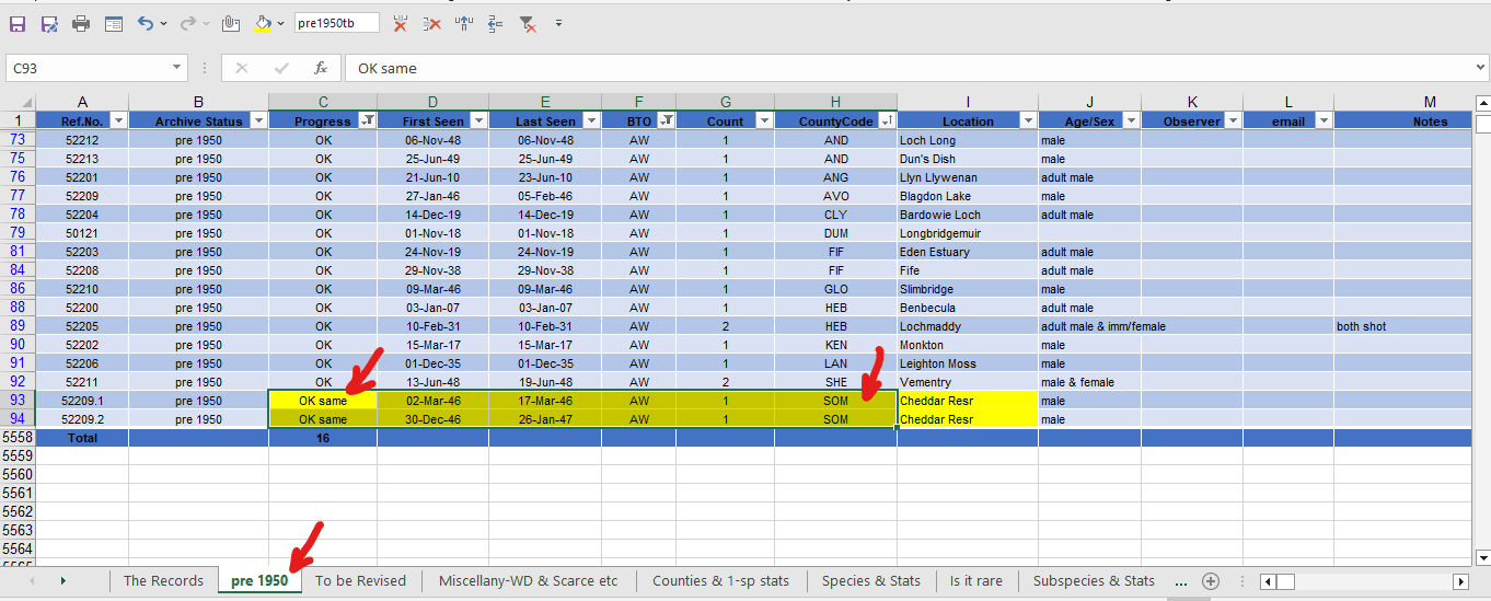

    In the "Counties & 1-sp stats" sheet column D should be recording one in D4 (see record 67212 in "pre 1950" sheet.

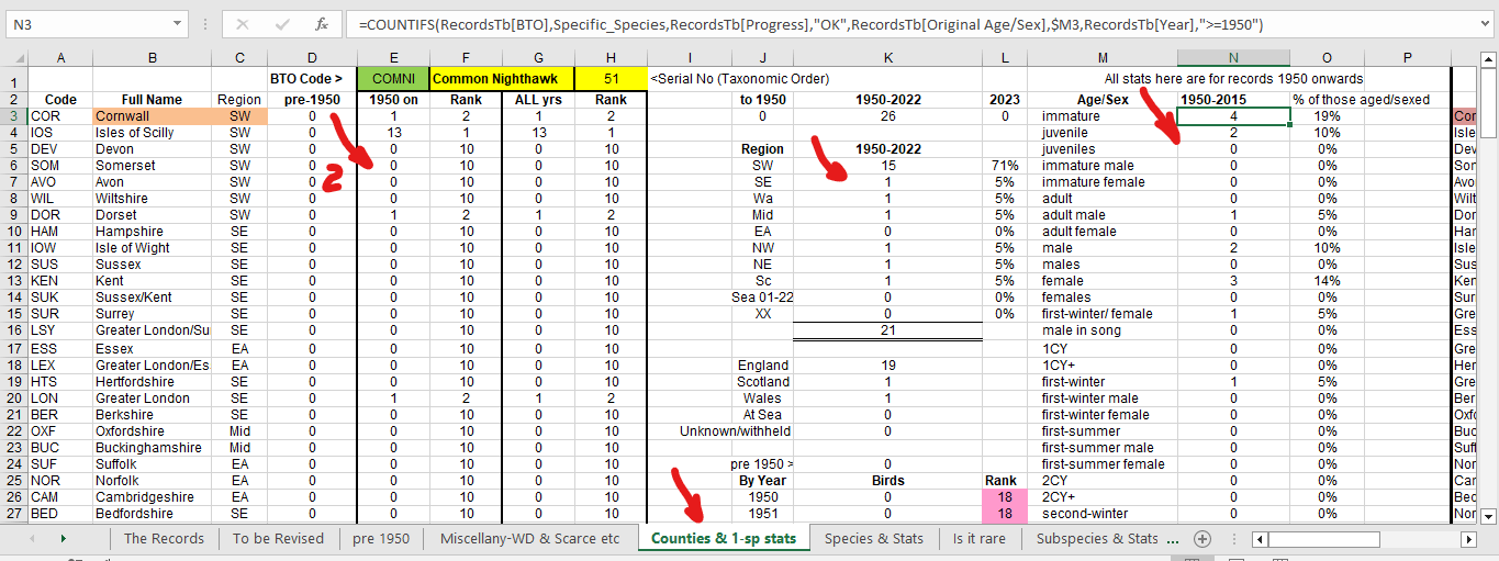

    To find a solution and correct the formulas we did the following:

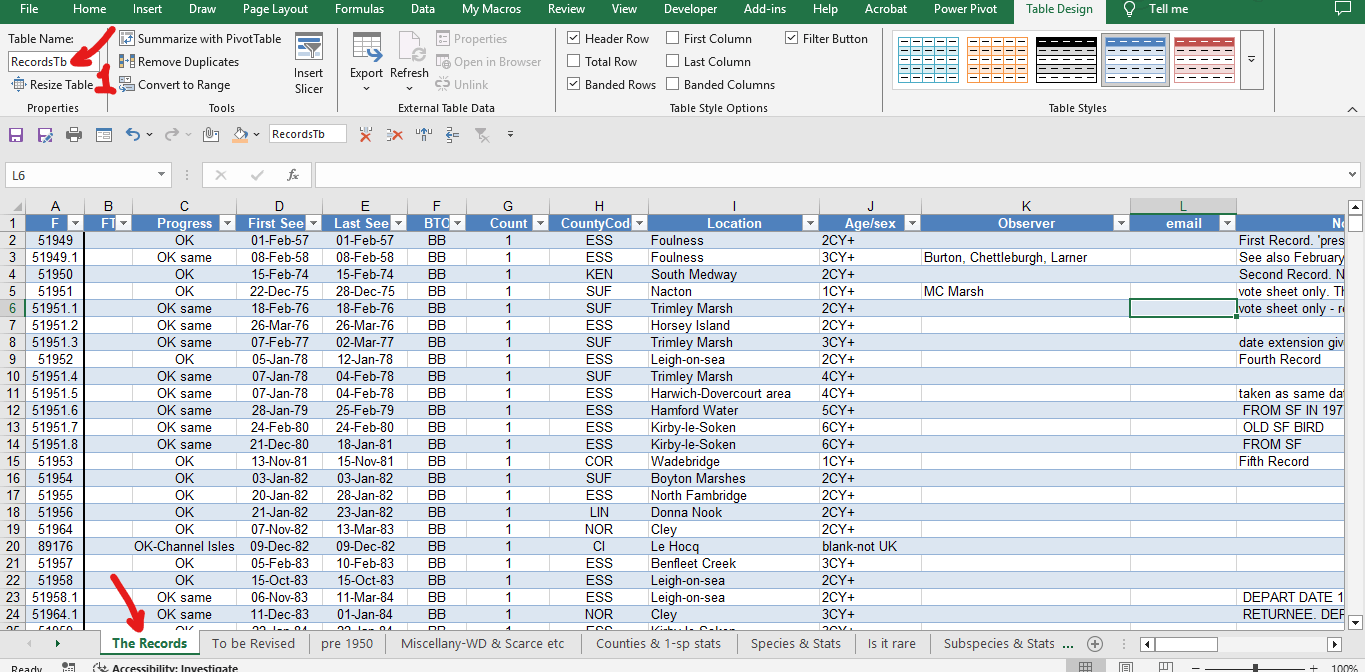

    1. On the Records tab, we converted the table to an Excel table (named "RecordsTb") to be used in the formulas as dynamic table/range reference, allowing you to add more records without having to adjust the formulas on the Stats sheets.
    1. On the "...Stats" sheet, a new set of formulas were entered

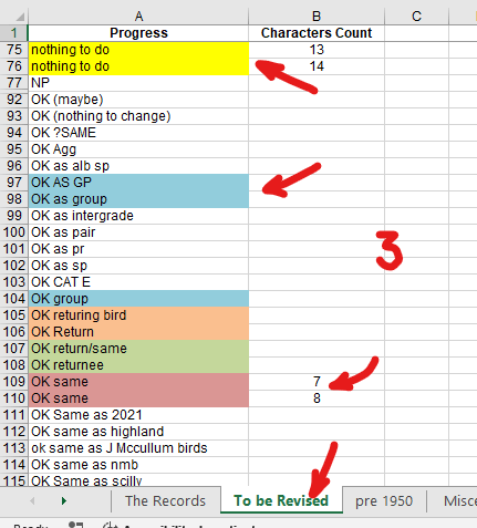

    1. I added a new sheet to show you the list of the unique entries/categories entered in the Progress column of the Records table, (142 in total,... it is a lot!!!!)
    Please, notice that the data entered in this column is very inconsistent, with many typos as shown on the cells I grouped by color in the picture below. It also has many ways to refer to one category, for example, the "OK...ish"
    All these records are not accounted for in the Stats sheet due to the inconsistency or misspelling in the data.

    in the "pre1950 sheet" I have found that when you select the date columns, then select Clear, Clear Formats off the ribbon it displays some rows in date form and some in text!
    How do you correct this please?
