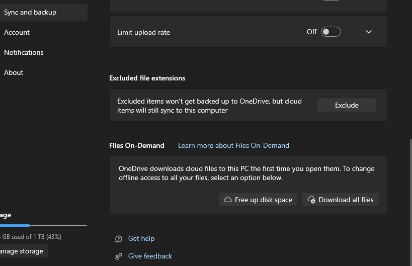

    Hi Jerry
    I was hoping to make this work, but my onedrive settings icon does not include an option to turn on and off the Files On Demand part. Is this accurate for everyone else?
    I include a snapshot.
    Thanks!
    Azucena
