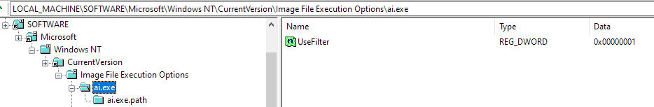

    2023-05-31T14:58:38+00:00
    Hi, i solved this by adding a key entry named ai.exe to
    *LOCAL_MACHINE\SOFTWARE\Microsoft\Windows NT\CurrentVersion\Image File Execution Options*
    Inside LOCAL_MACHINE\SOFTWARE\Microsoft\Windows NT\CurrentVersion\Image File Execution Options\ai.exe add the DWORD UseFilter with the value 1

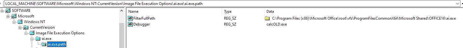

    Inside LOCAL_MACHINE\SOFTWARE\Microsoft\Windows NT\CurrentVersion\Image File Execution Options\ai.exe add a new key with an arbitrary name say ai.exe.path
    Inside LOCAL_MACHINE\SOFTWARE\Microsoft\Windows NT\CurrentVersion\Image File Execution Options\ai.exe\ai.exe.path add the STRING FilterFullPath with the value of the full command line without quotation. In my case: C:\Program Files (x86)\Microsoft Office\root\vfs\ProgramFilesCommonX64\Microsoft Shared\OFFICE16\ai.exe
    Inside LOCAL_MACHINE\SOFTWARE\Microsoft\Windows NT\CurrentVersion\Image File Execution Options\ai.exe\ai.exe.path add the STRING Debugger with the value of a simple program. In my case i use the old Windows Calculator which wont start in Windows 10. The simple program just needs to be found inside the System or User path.
    I had to use this kind of approach ( https://superuser.com/users/622538/e-grechnikov) since i own the game Alien Isolation with the executable ai.exe, which won't start either if i just added the ai.exe key to Image File Execution Options.
