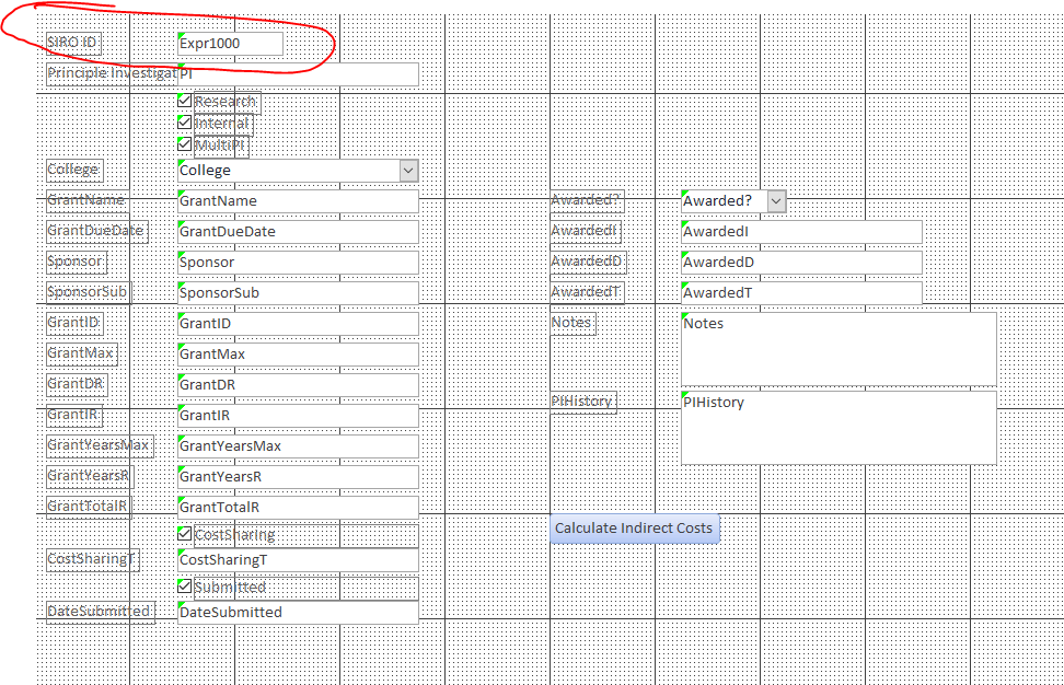

    I'm having the same issue basically, but I did notice something odd. Look at this:
    I have no idea why that says "Expr1000" instead of SIRO ID. I don't remember it saying that before I started having issues, but maybe I just didn't notice it. It doesn't seem like it should be relevant to the problem though.
    The field is SIROID. Maybe it says that b/c it's an autonumber. My point was having it assign a unique numerical ID that I could always pull from. I tried to set it up to search by professor name bt it won't work because somehow it's not associating my form with the table properly anymore. If I bypass the Form_Load() error, it shows this:
    Prior to things going wrong, it would always show me a specific record (even if it was the first one) with all associated fields properly populated.
