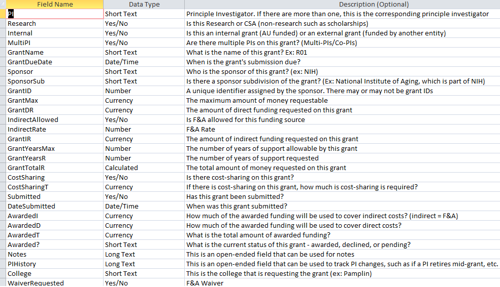

  1. ScottGem 68,840 Reputation points Volunteer Moderator
    2022-07-25T19:36:30+00:00
    Its hard to tell what you did differently without seeing exactly what you did,
    But you are heading down the worng path with your table structure, Your table strucutre should look more like this:
    tblGrants
    GrantID (Primary Key Autonumber)
    GrantName
    GrantDueDate
    GrantScope (text: either I or E
    GrantTypeID (Foreign Key to Research Type lookup table)
    SponsorID (FK to Sponsor table)
    SubSponsorID (FK)
    SponsorGrantID
    GrantMax
    GrantDR
    GrantMaxYears
    GrantReqYears
    GrantTotal
    DateSubmitted
    Notes
    CollegeID (FK to table of colleges)
    You would then need a table of Sponsors, Colleges and ResearchTypes (Research, CSA, etc.)
    You should have 2 tables for PIs
    tblPI
    PIID (PK Autonumber)
    Firstname
    LastName
    other info about PI
    tblPIAssigned
    PIAssignedID (PK Autonumber)
    GrantID (FK)
    PIID (FK)
    Primary (Yes/No)
    Indirect funding and Awards should be in separate tables

  3. ScottGem 68,840 Reputation points Volunteer Moderator
    2022-07-25T18:56:48+00:00
    So other issues. You said; "Make a table with the pertinent data"
    This raises red flags right off the bat. No way a database as you describe should be one table. Just on what you have posted you need a Grants table, a colleges table, an investigators table, a sponsors table and probably more. You probably should read upo on Noirmalization before going further. Befire yiou start designing forms yiou NEED to get your table strucutre squared away.
    Users should NOT directly access tables, You should use forms for all interaction between users and tables,
    When creating forms, I almost always use the Form wizard, rather than dragging and dropping fields onto the form. This makes it easier to properly design the form, thgen customize it to your needs.
