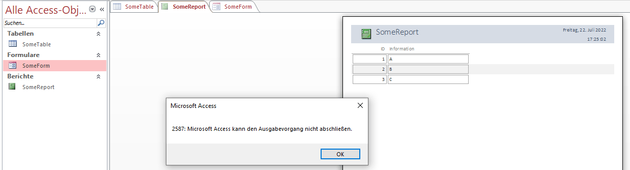

    I created a somewhat minimum (not) working example, reproducing the bug I encountered, when trying to export a report via VBA.
    1. Create new database
    2. create simple table
    3. create report
    4. create form
    4a. add button to form
    4b. add following VBA code for the button
    Option Compare Database
    Option Explicit
    Private Sub btnExport_Click()
        On Error GoTo EXPORT_ERROR
        Dim exportReportName As String
        Dim exportReportFile As String
        exportReportName = "SomeReport"
        exportReportFile = "SomeReport.xls" ' 'xls' or 'xlsx' doesnt seem to make any difference
        'I dont think this is in any way related to the bug
        DoCmd.OpenReport exportReportName, acViewPreview
        'This line fails
        DoCmd.OutputTo acOutputReport, exportReportName, acFormatXLS, exportReportFile, True
        'This code won't be reached in case of error, cause of the 'On Error' statement
        MsgBox "It Works :)"      'no, it doesnt :(
        Exit Sub
    EXPORT_ERROR:
        MsgBox Err.Number & ": " & Err.Description
    End Sub
    When you hit the button, a 'MsgBox' pops up with the Error number 2587.
