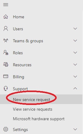

    My previous advice still stands. Each individual O365 system administrator with affected users needs to be raising their own service request in Admin Centre - and perhaps cross referring to the one I have already posted up if they are certain they are seeing the exact same fault. It only takes a few seconds to do this from the O365 Admin Centre menu (see below) so there is no excuse not to, if people want to see this fixed.
