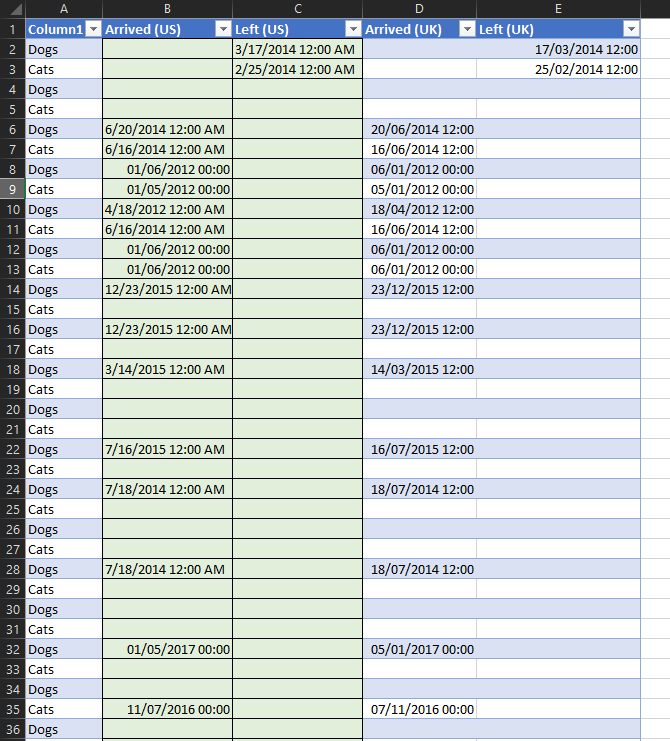

    Here is a VBA routine that properly converts the US dates to UK dates.
    This is adapted from a more general purpose routine I wrote some years ago, and I have made only minor alterations, so there is some extraneous code not strictly required for this purpose.
    Assuming that the original data was US dates; and that your system regional short date format is DMY, this routine seems to do what you want.
    Starting with the columns A, B, C from your workbook, it creates columns D,E with the UK dates
    Note that this not only turns the "text" date representations into UK dates, but also corrects the incorrect conversion of some US dates that had already occurred.

    Option Explicit

    'write the results 2 columns to the right of original column
    vRes(1, 1) = Replace(vRes(1, 1), "US", "UK")
    With R.Offset(0, 2)
        .Value = vRes
        .NumberFormat = "dd/mm/yyyy hh:mm"
    End With
