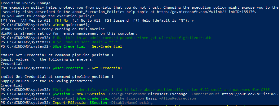

    2020-08-17T22:19:58+00:00
    Hi Maria,
    Yes, you can run this from your machine in an elevated PowerShell.  I don't know why this dumb wysiwyg editor keeps changing everything I put in but here's a screenshot that might help.  The fact that it's connecting to "-ConnectionUri https://outlook.office365.com/powershell-liveid/" is why it should work remotely.  Hope this makes sense.
    Since this account was already fixed it just throws errors after this point but the commands above should work.
    Here's the script in plain text:
    https://jarrids.com/docs/535GoDaddyStinks.txt
