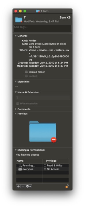

    I've looked through all those folders and of course because there is no update in progress, I don't see anything. Mainly I wanted to see if I could spot a potential permissions problem that might prevent the update download (just a theory I'm pursuing because of the way it acts - the download progress bar displays and the bars move across the screen but don't complete so it appears that it's trying to download but then gives the message - "one or more update packages could not be downloaded" - so what could prevent them from downloading? It's not obvious what that is but a theory is a good start.
    As I have completely removed and replaced the entire MS OFFICE installation and run every utility I have including Disk Utility and Cocktail, and run SAFE MODE which remove unneeded caches, I'm pretty much down to the one I really hate thinking about - replacing OSX.
    I hate that because it always comes with unexpected issues - it is definitely not benign - I get lost settings that aren't immediately apparent and I don't remember what they are, etc. But I guess that's the next place I need to go.

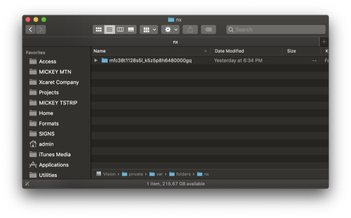

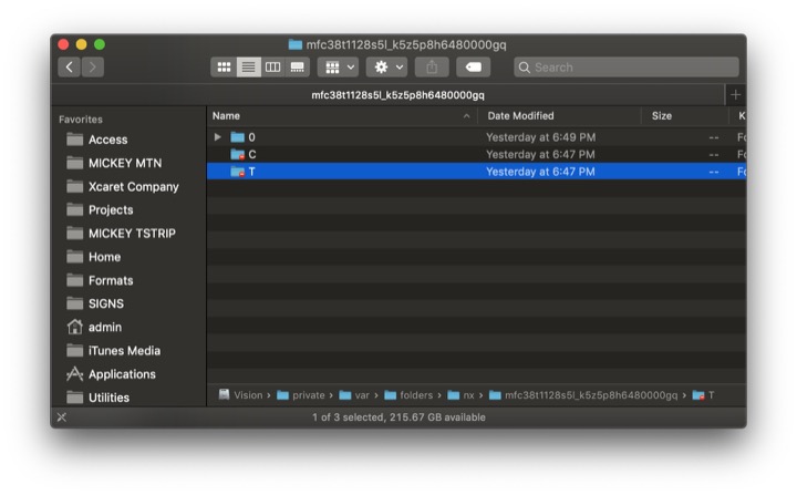

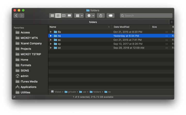

    Qing
    I'm not seeing exactly the path you're describing. Here is what I see.
    I couldn't find the 5v folder so I picked the one with the most current date - none of the others are current.
    And now I start seeing folder that I do not have access to... note the read tags? The "O" folder has a bunch of Apple files but nothing MS.
    And permission on these files says 'Fetching...' and doesn't really come up with a "system" tag so I cannot get beyond these folders.
    Any of your files have these red tags? Perhaps the reason I cannot download files into this area is this? I don't know much about permissions at this level and in these folders so I'll have to do some research to see if I can find out more about what I'm looking at.
