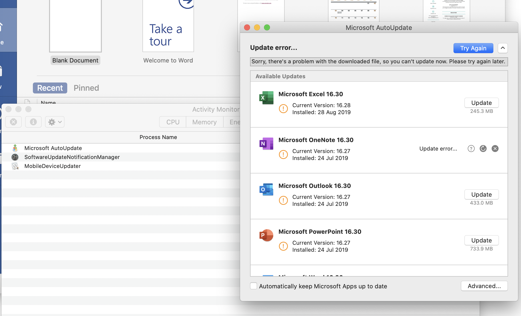

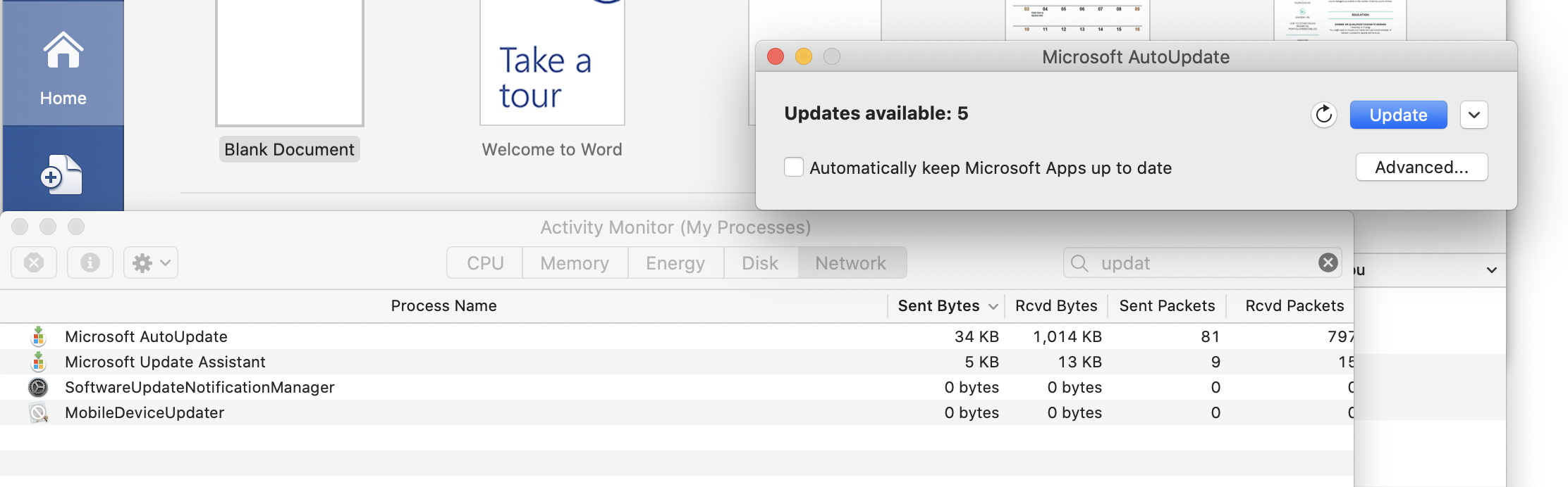

    Hi Alex and everyone else.
    I downloaded MAU 4.16 and ran via MS Word and got the same error albeit in a new looking MAU interface.
    I have attached screenshots showing the running processes after starting MAU and then after trying to update (the date timestamps are out of sequence as I re-did update to get the before image)
    Thanks
    Steve
    2019-10-24T15:19:33+00:00
    Alex
    I had checked the Apple Root CA certificate setting long ago and found this was not my solution/issue. It certainly appears to be one cause. I hope that Steve can update his MAU to 4.16 and check the StandAloneUpdaterDaemon to see if it's running. As I'm already updated on 4.16 and 16.30 I'm no help.
    PS - I'm still running Mojave 10.14.6 - Steve is on Catalina so we're looking at potentially two different setups.
