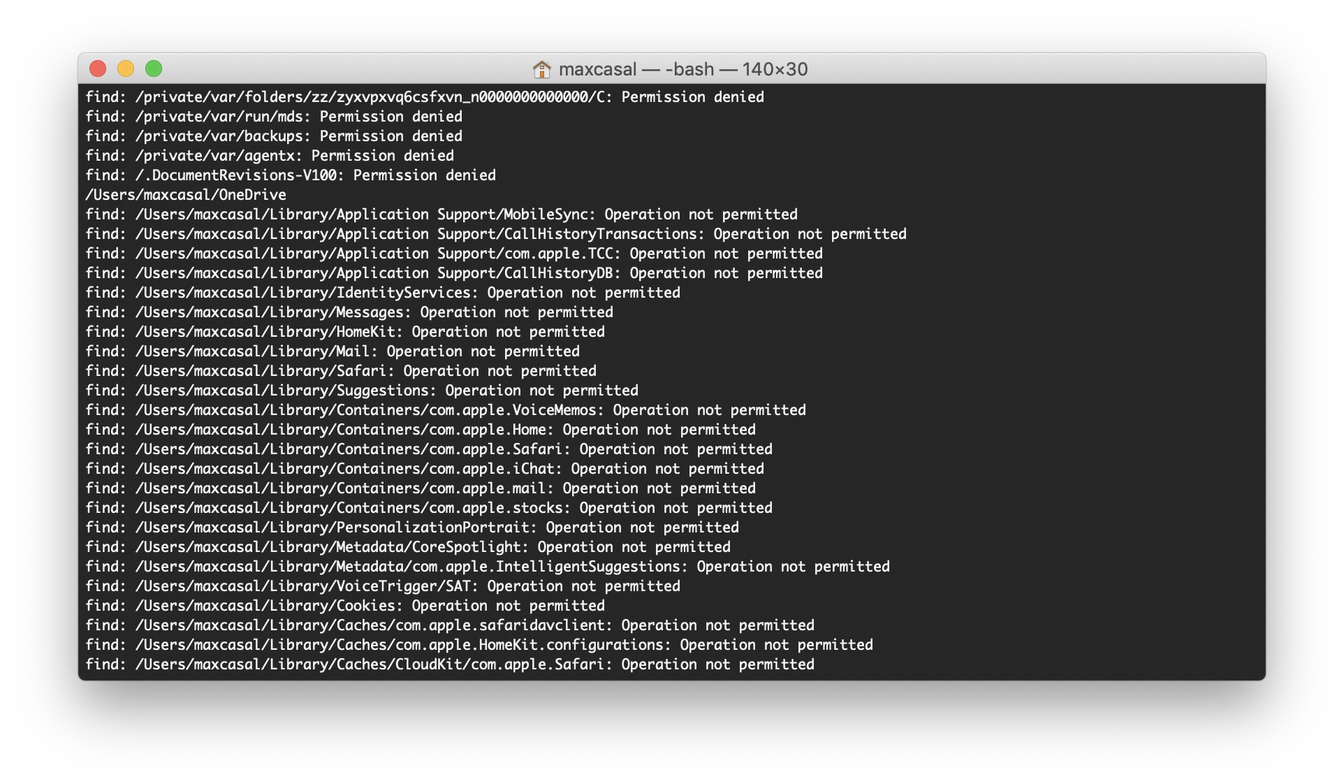

OneDrive for Mac (v 18.222.1104.0007) is causing error in OS X Disk Utility (OS X Mojave 10.14.2 and 10.14.1):
warning: inode_val: object (oid 0xcb5b5): invalid bsd_flags (0x10)
Found this being OneDrive by re-installing the operating system and also by converting 0xcb5b5 to decimal format and running " find / -inum 832949 " in terminal.

    Then run
    find / -inum 1194961
    Fix it!
