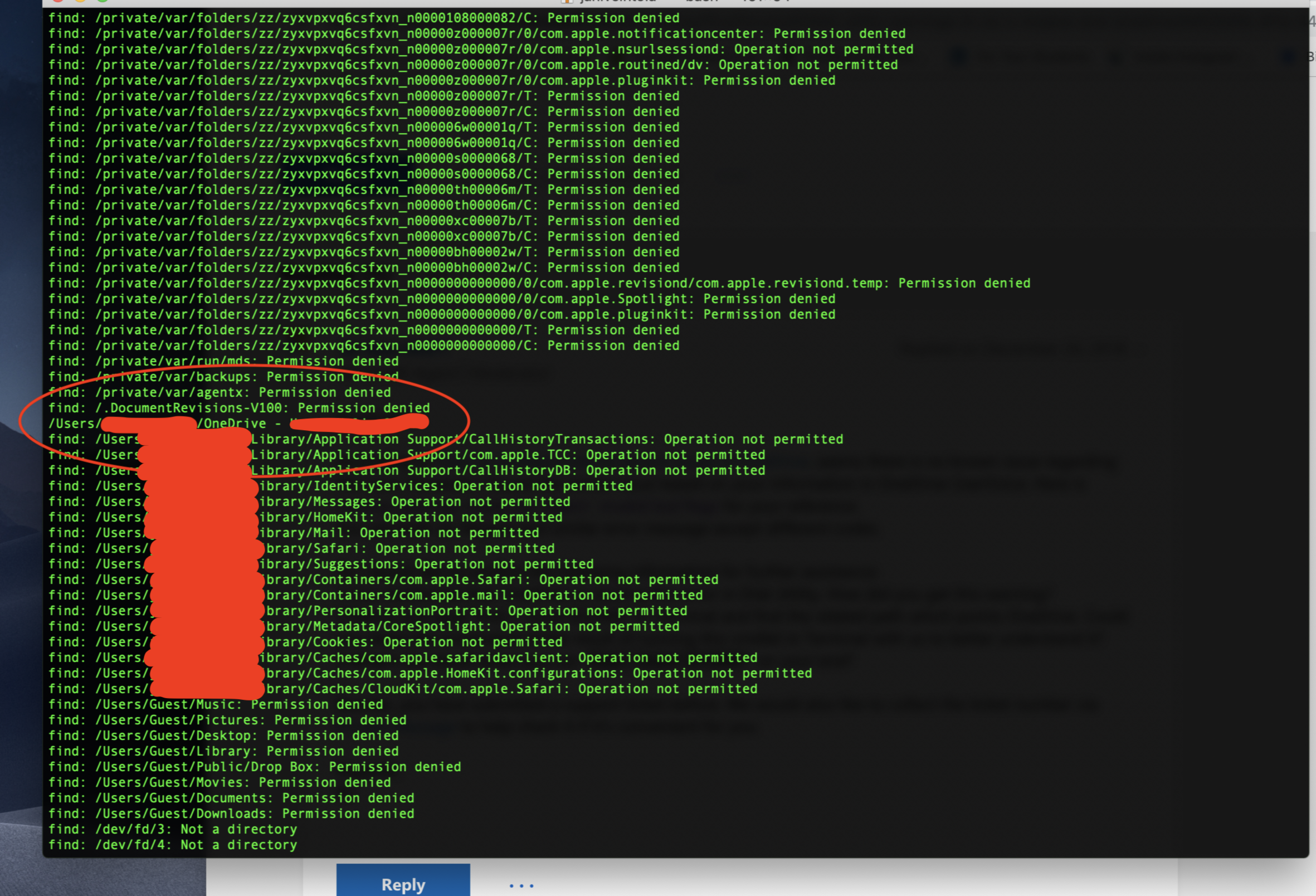

Found this being OneDrive by re-installing the operating system and also by converting 0xcb5b5 to decimal format and running " find / -inum 832949 " in terminal.

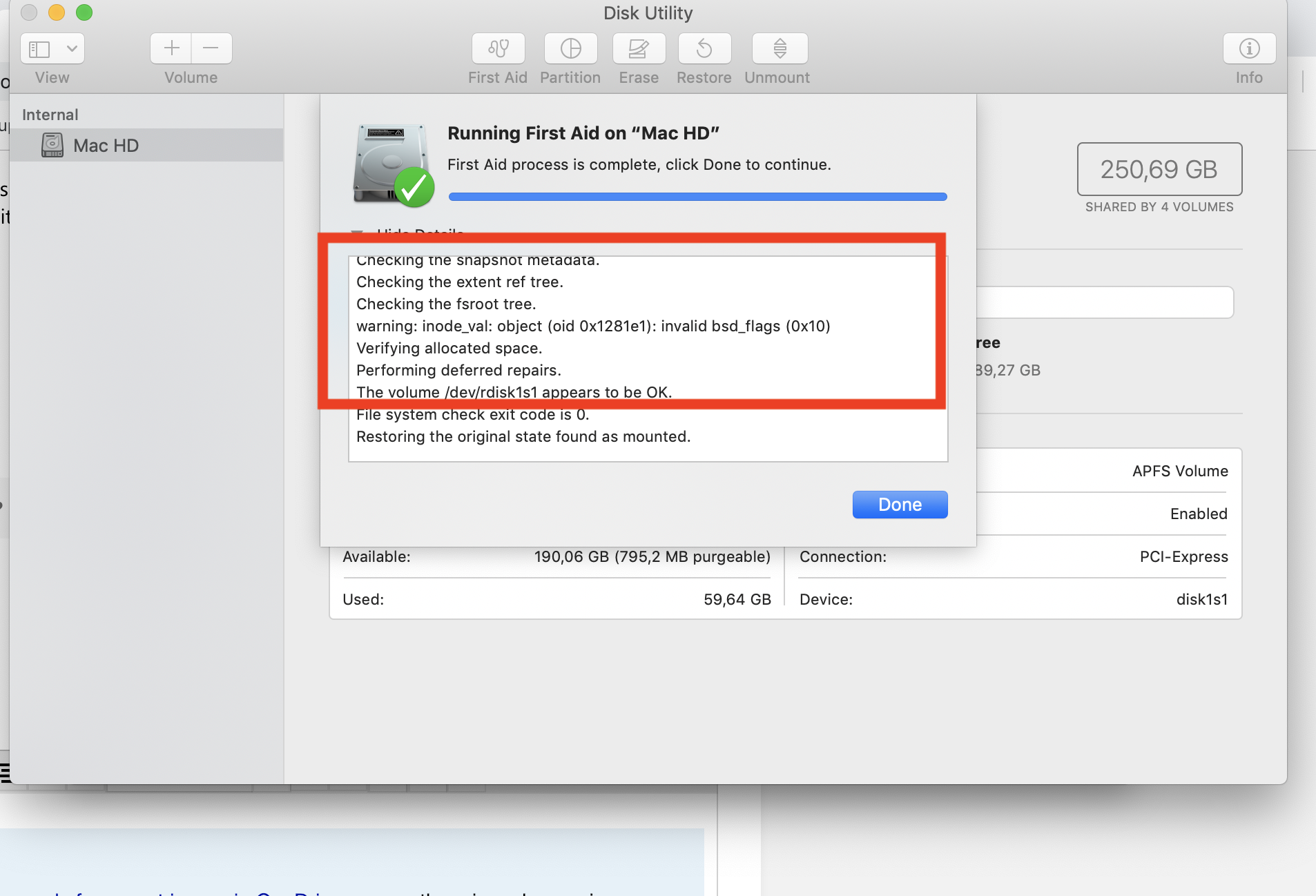

Only thing happened after "clean install of OneDrive" was that the DiskUtility error is now this (the object value has changed):
warning: inode_val: object*(oid 0x1281e1**): invalid bsd_flags (0x10)*

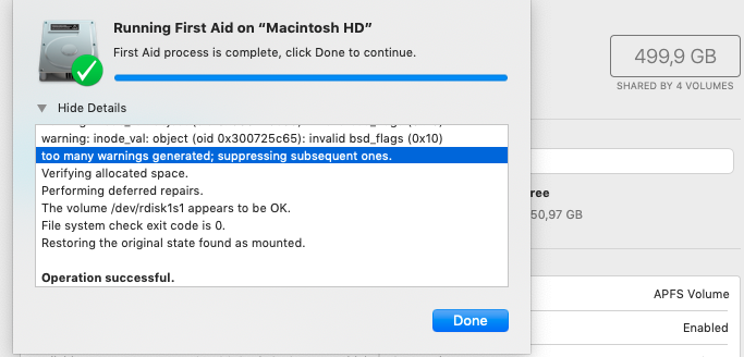

    I have the same problem with mojave 10.14.2. If I remove Onedrive folder, Diskutil warning disappear. But when Onedrive app (macappstore, latest version) make new folder, Diskutil make warning again.
    I have this problem on my iMac retina late 2014 (SSD-APFS) and my Macbook pro late 2016 (SSD-APFS with filevault).
    In addition, full system recovery from the time machine backup stops on both computers and fails.

    2.Seems you type "find / -inum 832949" in Terminal and find the related path which points OneDrive. Could you share the screenshot of the result of running this cmdlet in Terminal with us to better understand it?

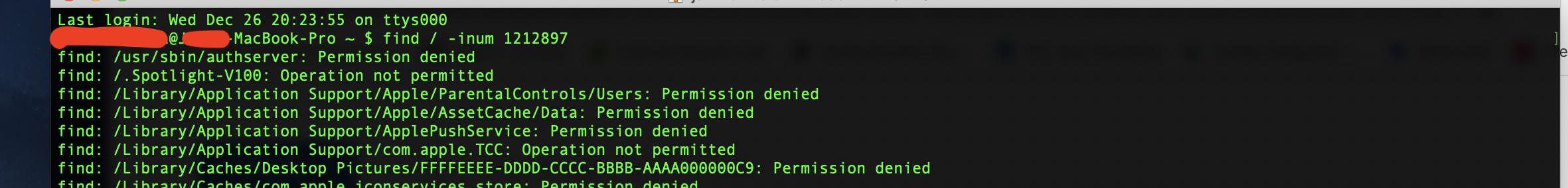

    3.What's the result when you run "find / -inum 1212897" on your end?

    3. Here is the result with "find / -inum 1212897" on your end? (screenshots)
