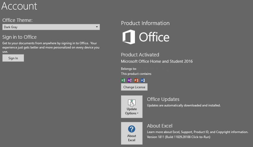

    3.In Word or PowerPoint, please click File>Account and capture a full screenshot of Product Information.
