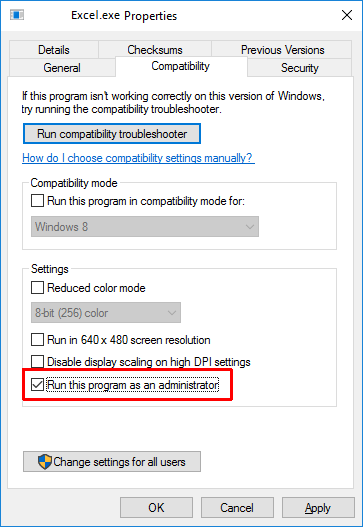

    I got my Excel to open in admin mode by default.
    I opened my start menu - right clicked on "Excel" and clicked "More" and then "Open file location" (Mine is in Danish - so translation can be a bit off)
    That opens Explorer where I right click the Excel Shortcut - and again click "Open file location"
    This opens the Microsoft folder with the Excel.exe file.
    Now - Right click that and click "Properties".
    Find the tab called "compatibility" and put a check mark in "Run this program as an administrator"
    This opens Excel in admin mode every time for me - even when clicking an excel file directly :)
