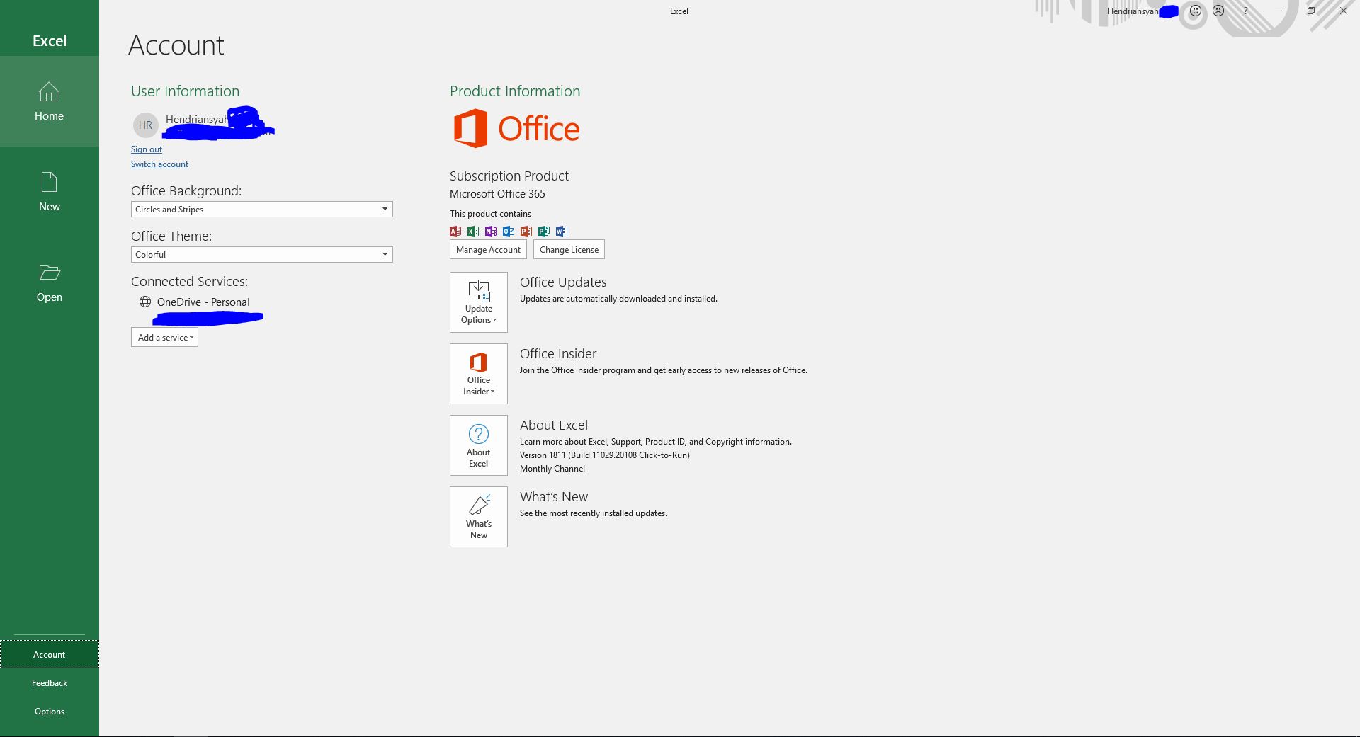

    2019-01-01T14:30:23+00:00
    Hello, I also experiencing this after Office 2019 released. (I use Office 365 Personal which continously receive updates, so it will automatically updated to Office 2019).
    No matter how complex my data, it keeps crashing. Already tried ALL mentioned solutions above. Below the error and it seems everyone experiencing the same problem :
    Faulting application name: EXCEL.EXE, version: 16.0.11029.20108, time stamp: 0x5c0b39a9
    Faulting module name: mso20win32client.dll, version: 0.0.0.0, time stamp: 0x5c099da4
    Exception code: 0x012a168b
    Fault offset: 0x00000000001ea7b3
    Faulting process id: 0x2f78
    Faulting application start time: 0x01d4a1dc6d583e4f
    Faulting application path: C:\Program Files\Microsoft Office\Root\Office16\EXCEL.EXE
    Faulting module path: C:\Program Files\Common Files\Microsoft Shared\Office16\mso20win32client.dll
    Report Id: e8d61***9ae65f
    Faulting package full name:
    Faulting package-relative application ID:
    below my current version of Excel
    Thank you.
