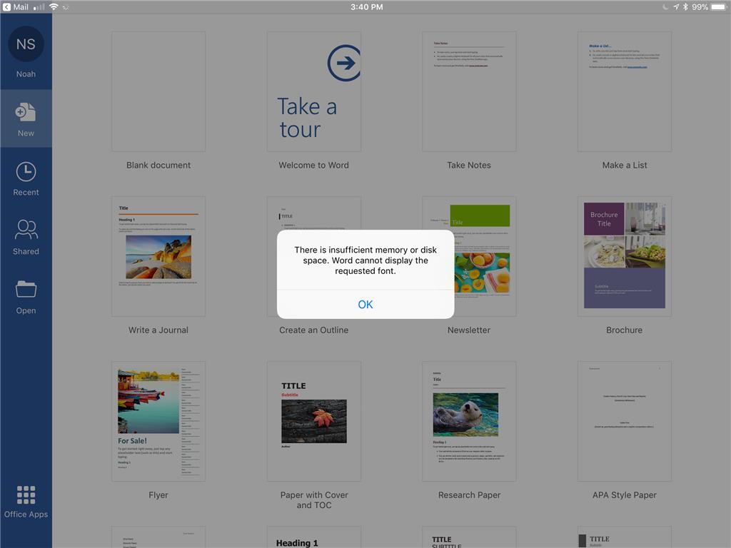

I have been using Microsoft Word for iPad to write and edit documents for a while now and it has been working well. I have some custom fonts installed on my iPad, and those have been working great with Word as well. Until iOS 11. After I updated my iPad to iOS 11, I got an error message every time I opened a file that relied on my user-installed fonts: “There is insufficient memory or disk space. Word cannot display the requested font.”. And the file closes and/or stays open but doesn’t display my fonts. Is this a known issue? Anyone experiencing this?  I’m hopeful that this will be addressed in the first post iOS 11 update for Word, but I haven’t seen anything about it online.

    1. iOS 11.0.3 and Word 2.6 (171004)
    2. I installed using the AnyFont app, which uses an iOS configuration profile. When I remove the fonts, the document loads normally in Word.
    3. I'm using the Equity fonts (Equity Text A, Equity Text B, Equity Caps A, Equity Caps B, etc.).
    4. Screenshot of error message attached.
    5. Sending video in private message.
