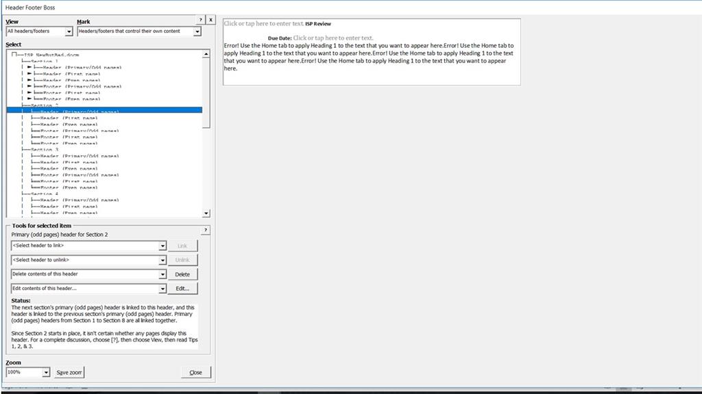

    Yes, I can toggle the field and it'll show me the field definition, even when it doesn't display the field contents. So the field is there, it just doesn't always display. And in section two and beyond, I get the error message in the Header Footer Boss screen, same as in the previous picture. Not sure how to react to that. Hhhmmm...

    I insert the field as a Cross-Reference. I then edit the field - right-click, Edit, choose "StyleRef" and "Heading 1", Check "Search from bottom of page to top", Check "Preserve formatting during updates". Click OK and the field disappears.
    I did use the tool on it. The first section is fine, the second section gives me an error I don't understand. Maybe you can help? Thanks!!!

    OK, I like the tool. It's having a little problem displaying the list of headers & footers in the "Select" box on the left side - the text is overlapping. A little tough to read, but still possible. If it were implemented using a TreeView object (looks like a ListBox now), it would look and behave much better.
    By marking "H/Fs that control their own content", I see that section 3's Primary/Odd Header controls its own content, rather than being linked to the previous section's content. I used the buttons to try to unlink, then re-link section 3's content to section 2 - it seemed to go through the motions, but after it was done, nothing changed. This is pretty much the same behavior as when I tried to do it using the standard Word commands. My guess is that the tool is just using the same standard Word commands to try to do the same thing.
    This may mean what you said - that the file is "broken". I will wait to see what your contacts come up with. (Hopefully, I won't need to rebuild the file - ugh!)
