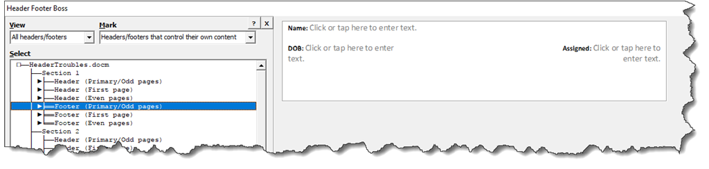

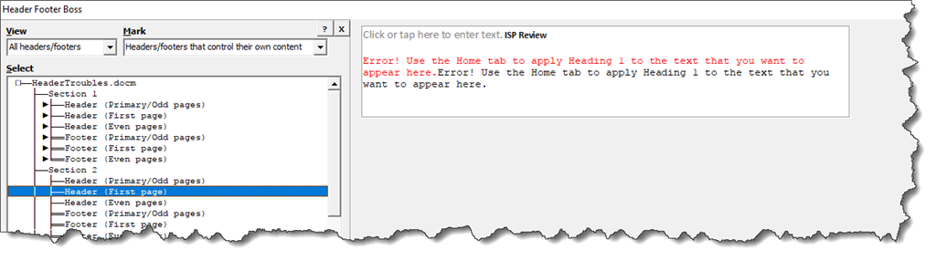

    OK, I like the tool. It's having a little problem displaying the list of headers & footers in the "Select" box on the left side - the text is overlapping. A little tough to read, but still possible. If it were implemented using a TreeView object (looks like a ListBox now), it would look and behave much better.
    By marking "H/Fs that control their own content", I see that section 3's Primary/Odd Header controls its own content, rather than being linked to the previous section's content. I used the buttons to try to unlink, then re-link section 3's content to section 2 - it seemed to go through the motions, but after it was done, nothing changed. This is pretty much the same behavior as when I tried to do it using the standard Word commands. My guess is that the tool is just using the same standard Word commands to try to do the same thing.

    You may want to use the Word Toolkit for Advanced Management of Word Headers and Footers. It is a diagnostic.
    Here are a couple of screen shots:
