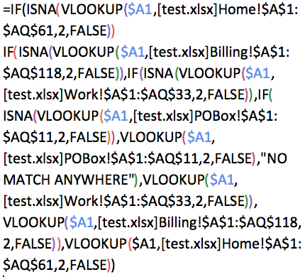

    I think you were looking at the wrong post. I did actually use the one with $A3 and posted a screenshot of the formula in the cell. As I said in that post, it still didn't work and I got the same error.
    2017-10-22T06:24:00+00:00
    Sorry the screenshot below shows what it looks like in B3 but when I click enter, it gives me the error again.
    why does that have $A1 in the formula when the last formula I posted had a $A3?
    see below:
    =IF(ISNA(VLOOKUP($A3,[test.xlsx]Home!$A$1:$AQ$61,4,FALSE))
    IF(ISNA(VLOOKUP($A3,[test.xlsx]Billing!$A$1:$AQ$118,4,FALSE)),IF(ISNA(VLOOKUP($A3,[test.xlsx]Work!$A$1:$AQ$33,4,FALSE)),IF(ISNA(VLOOKUP($A3,[test.xlsx]POBox!$A$1:$AQ$11,4,FALSE)),VLOOKUP($A3,[test.xlsx]POBox!$A$1:$AQ$11,4,FALSE),"NO MATCH ANYWHERE"),VLOOKUP($A3,[test.xlsx]Work!$A$1:$AQ$33,4,FALSE)),VLOOKUP($A3,[test.xlsx]Billing!$A$1:$AQ$118,4,FALSE)),VLOOKUP($A3,[test.xlsx]Home!$A$1:$AQ$61,4,FALSE))
