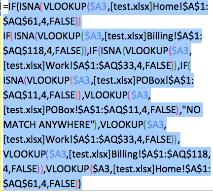

    I still get the error - see screenshot below:
    2017-10-22T06:17:17+00:00
    ok paste this in B3:
    =IF(ISNA(VLOOKUP($A3,[test.xlsx]Home!$A$1:$AQ$61,4,FALSE))
    IF(ISNA(VLOOKUP($A3,[test.xlsx]Billing!$A$1:$AQ$118,4,FALSE)),IF(ISNA(VLOOKUP($A3,[test.xlsx]Work!$A$1:$AQ$33,4,FALSE)),IF(ISNA(VLOOKUP($A3,[test.xlsx]POBox!$A$1:$AQ$11,4,FALSE)),VLOOKUP($A3,[test.xlsx]POBox!$A$1:$AQ$11,4,FALSE),"NO MATCH ANYWHERE"),VLOOKUP($A3,[test.xlsx]Work!$A$1:$AQ$33,4,FALSE)),VLOOKUP($A3,[test.xlsx]Billing!$A$1:$AQ$118,4,FALSE)),VLOOKUP($A3,[test.xlsx]Home!$A$1:$AQ$61,4,FALSE))
    2017-10-22T06:12:36+00:00
    Sorry the screenshot below shows what it looks like in B3 but when I click enter, it gives me the error again.

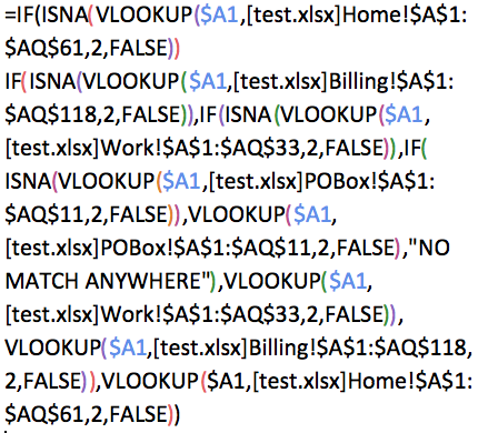

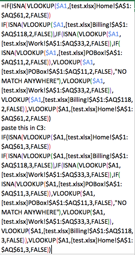

    Ok I tried that one and I still got the error. The following are the screenshots of the formulas in the cells - B3 and C3:
