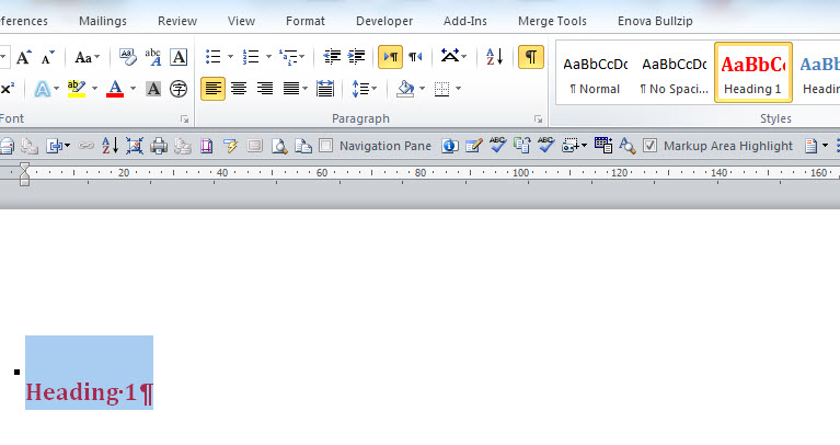

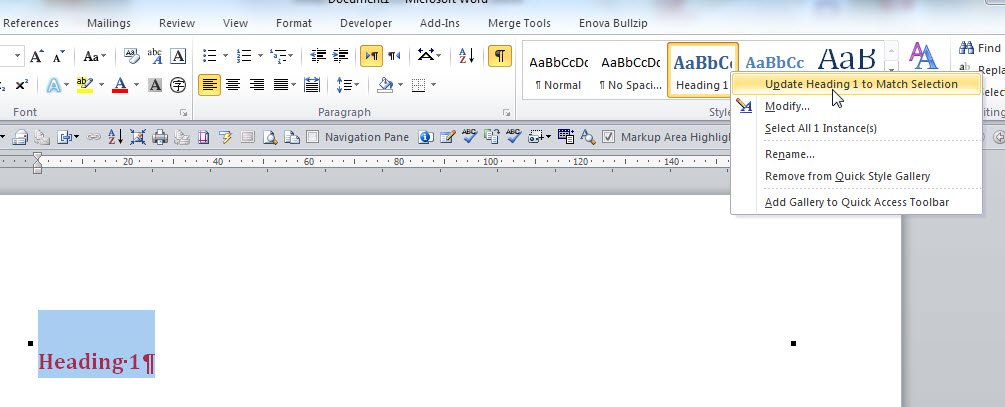

    However in Windows versions of Word, if I insert a Heading 1 style paragraph and the change the font to Red and then use the Update Heading 1 to Match Selection
    that is what happens

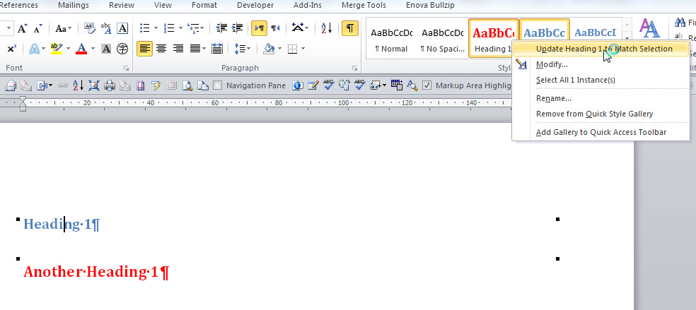

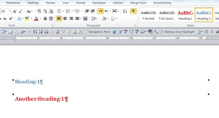

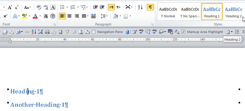

    Further, if I change the style applied to the text to Heading 2
    and then use the "Update Heading 1 to Match Selection"
    that is also what happens
