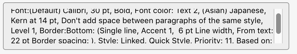

    Take a look at my third post in this thread (the last one dated Feb. 27).  There I explain that I am not "changing their font, paragraph formatting etc. via the Font and Paragraph dialog," because the styles are very complex. [ At the bottom of this post is a screenshot showing just a portion of the style specification for one of the Headings.]

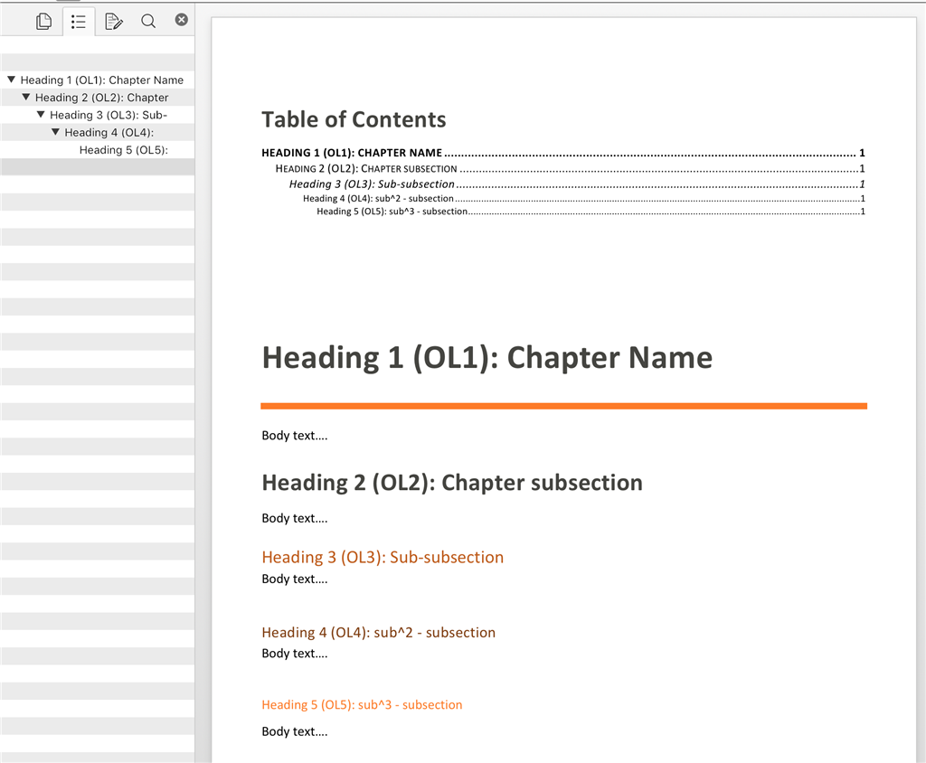

    I.e., here's the look I want, which I've achieved using custom Headings.  Note the consistency between the TOC and the Document Map.  [These are identical in appearance to the styles provided with the "Write a Journal" template, except I've adjusted the font sizes to better distinguish the different levels, and changed the typeface to Calibiri.  And, of course, I've given Heading 1 approximately theappearance of the original Title, Heading 2 approximately the appearance of the original Heading 2, etc.  But, again, I've not changed their functions.] But, based on Shauna Kelly's article, I would prefer to achieve this same appearance, except where my document's structure is based on built-in Headings instead of custom Headings. [OL = Outline Level]:
