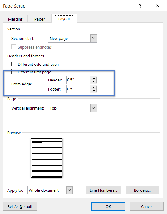

    Once the Header\Footer pane has been accessed, as appatently it was in this case to remove the header, there will always be an empty paragraph in the header and footer and the distance of that paragraph from the edge of the page will be the distance specified on the Layout tab of the Page Setup dialog.  If that distance is more than the margin setting, the margin can be offset.
    While that may not happen on the computer on which the document was created, it will most definitely occur if the document is re-laid out on another device.

    I was going to point out that you haven't answered the question about the setting for header distance from the edge, but as far as I can tell, in Word 2013, this setting has no effect if there is nothing in the header. You may as well check it, too, though.

    Maybe there's something don't know: if I have removed the header and footer, is there still a distance of the header and footer from the edge of the page? I wouldn't know how to measure that if there was.
    Yes, the top and margin setting is less than default (narrow setting in your description, rather than normal which is 25mm). I had no idea that Word can not handle anything less than 12.7mm - in the old days it was limited to printer drivers, which would give a warning dialogue.
    So, if we set the margin to less than 12.7mm, it will save fine, will print fine (because it does), my laptop will love it, but Word for Android, rather than increasing the margin or giving a warning, will "correct" it by inserting an empty header? A strange choice for a developer to find as a fix.
