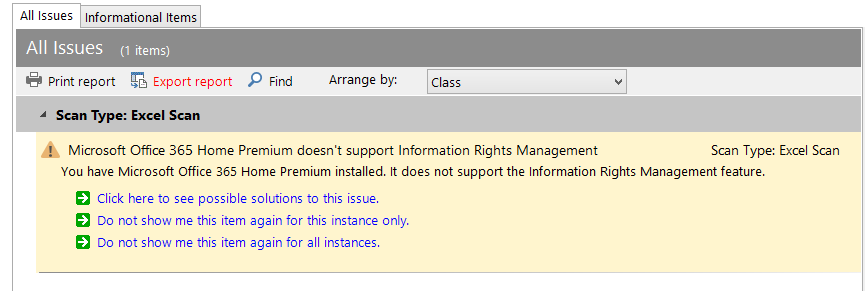

    I've run the offCAT and I have the report, how do I send it, no apparent issues found, just this.
